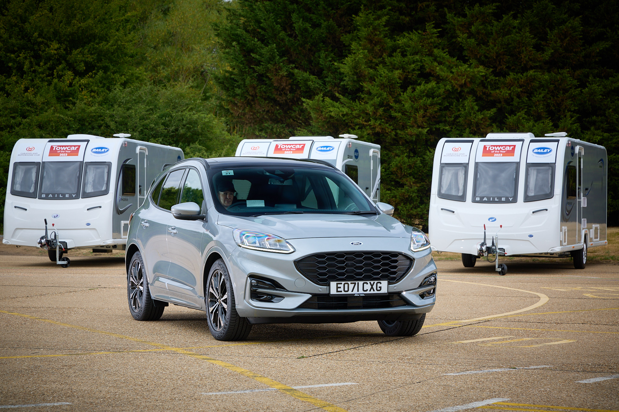

SUV, Ford retractable
Performance
  • Number of cylinders: 4
  • Size of engine in cc: 2500
  • Number of gears, gearbox: Ford-developed power-split automatic with continuously variable ratio, automatic
  • Fuel: Petrol, mild hybrid
  • Power: All wheel drive
  • Power (bhp@rpm): 180 @ 5500
  • Torque (lb/ft@rpm): 147
  • Towing acceleration 0-60mph: 17.05s
  • Towing acceleration 40-60mph: 9.54s
  • Towing deceleration 60mph-0: 51.98m
  • CO2 g/km: 137
Weights for towing
  • Kerbweight (kg): 1765
  • Gross vehicle (kg): 2315
  • Caravan (kg): 1500
  • Noseweight (kg): 90
Pricing
  • Price range of vehicle: £32,095 - £42,455
  • £ (price as tested) includes £950 towing gear charges: £42,415
  • Insurance group: 20
  • ISOFIX Mountings: 2
  • NCAP safety rating: Five stars
Read more about the Ford Kuga
Check with your local Ford dealer for the latest prices and availability

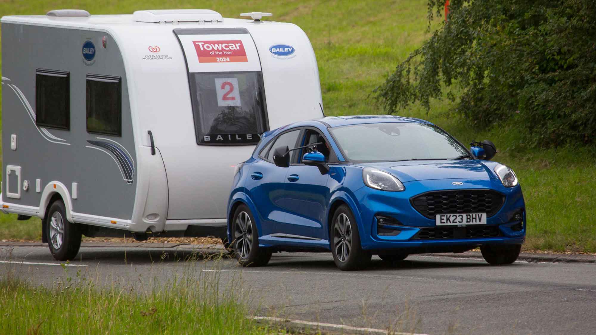

SUV, Ford fixed
Performance
  • Number of cylinders: 3
  • Size of engine in cc: 999
  • Number of gears, gearbox: 6 / Manual
  • Fuel: Petrol mild hybrid
  • Power: Front wheel drive
  • Power (bhp@rpm): 153 @ 6000
  • Torque (lb/ft@rpm): 177 @ 2500
  • Towing acceleration 0-60mph: 15.4s
  • Towing acceleration 40-60mph: 10s
  • Towing deceleration 60mph-0: 47.6m
  • Towing deceleration 60mph-30mph: 11m
  • CO2 g/km: 124 - 126
Weights for towing
  • Kerbweight (kg): 1280
  • Gross vehicle (kg): 1765
  • Caravan (kg): 1088
  • Noseweight (kg): 75
Pricing
  • Price range of vehicle: £24,940 - £32,420
  • £ (price as tested): £27,360
  • Total of first three years’ car tax: £540
  • Insurance group: 12E
  • ISOFIX Mountings: Two
  • NCAP safety rating: Four
Read more about the Ford Puma ST-Line 1.0 Mhev 155ps 6 speed manual
Check with your local FORD dealer for the latest prices and availability

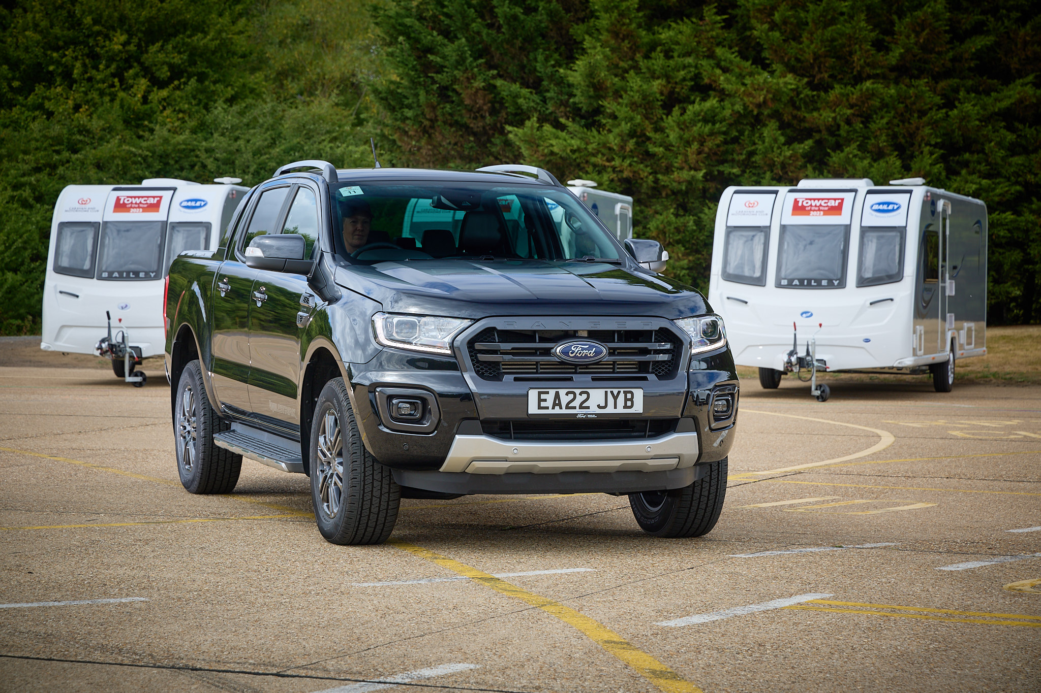

Pick up, Ford fixed
Performance
  • Number of cylinders: 6
  • Size of engine in cc: 2996
  • Number of gears, gearbox: 10 / Auto
  • Fuel: Diesel
  • Towing acceleration 40-60mph: 8.1
  • Towing deceleration 60mph-0: 50.4m
  • Towing deceleration 60mph-30mph: 12.45m
  • CO2 g/km: 264
Weights for towing
  • Kerbweight (kg): 2283
  • Gross vehicle (kg): 3350
  • Caravan (kg): 1941
  • Noseweight (kg): 225
Pricing
  • Price range of vehicle: £33,066 - £59,530
  • £ (price as tested): £53,460
  • Total of first three years’ car tax: £960
  • Insurance group: 42E
Read more about the Ford Ranger Wildtrak Double Cab 3.0L TD Ecoblue V6 240PS
Check with your local FORD TRANSIT CENTRE  dealer for the latest prices and availability

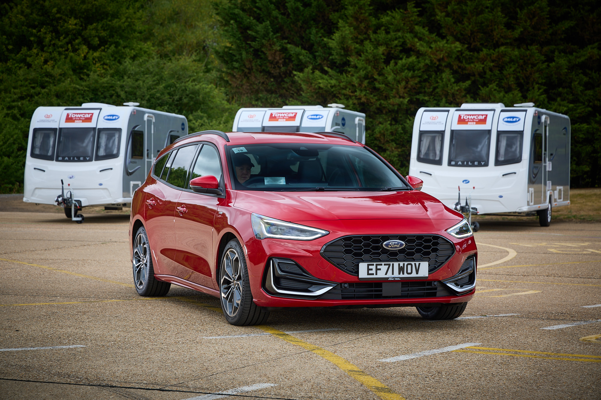

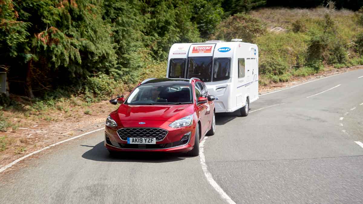

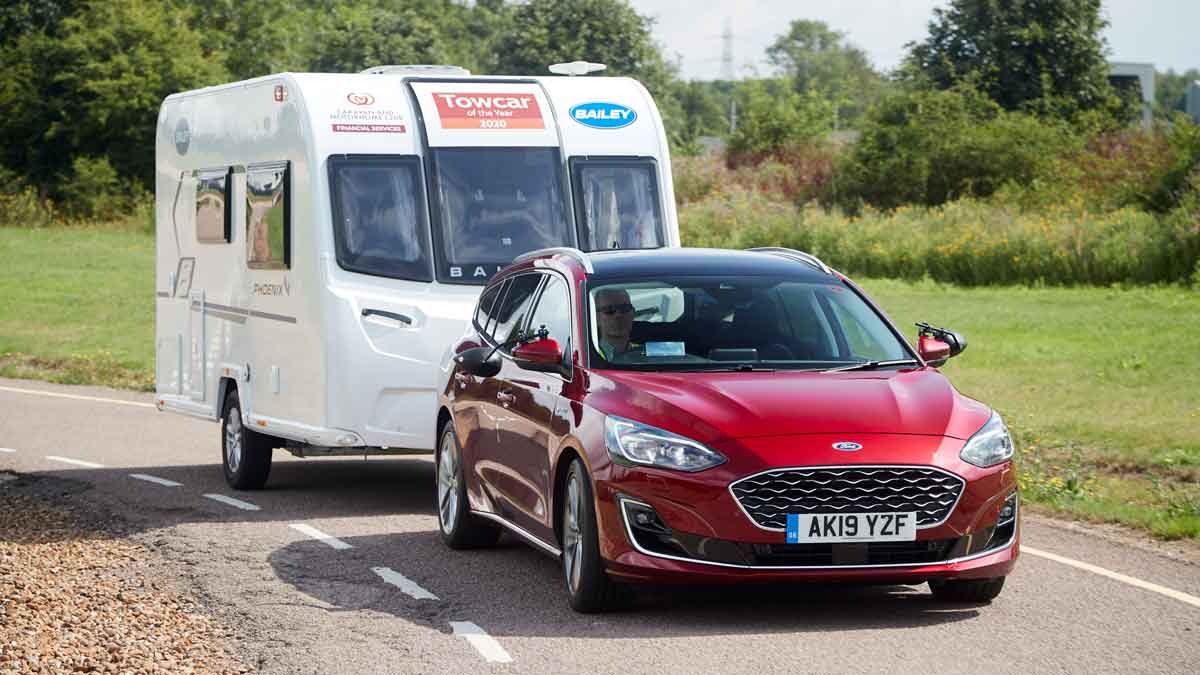

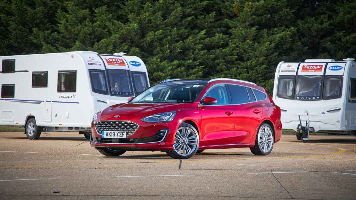

Estate, Ford detachable
Performance
  • Number of gears, gearbox: 7 / Manual
  • Fuel: Petrol
  • Power: Front wheel drive, Powershift dual clutch
  • Torque (lb/ft@rpm): 177 @ 2100-5500
  • Towing acceleration 0-60mph: 5.71s
  • Towing acceleration 40-60mph: 10.0s
  • Towing deceleration 60mph-0: 51.2m
  • Towing deceleration 60mph-30mph: 12.9m
  • CO2 g/km: 129
Weights for towing
  • Kerbweight (kg): 1451
  • Gross vehicle (kg): 2005
  • Caravan (kg): 1233
Pricing
  • Price range of vehicle: £25,910 - £37,710
  • £ (price as tested) includes £250 tow bar pre-installation charges and £700 towing gear equipment: £33,450
  • Total of first three years’ car tax: £520
  • Insurance group: 17
Read more about the Ford Focus Active Vignale Estate 1.0L EcoBoost 155PS mHEV

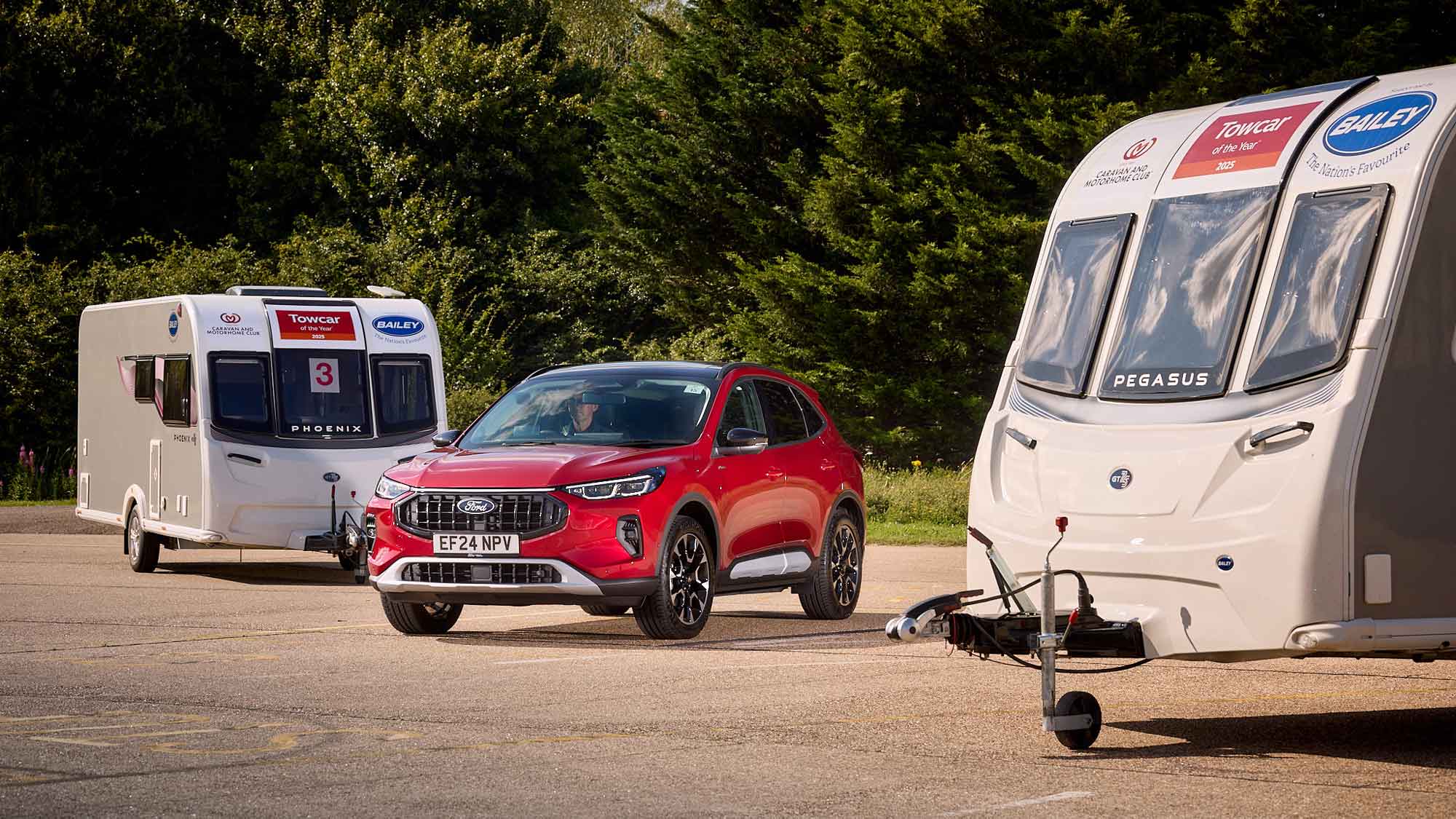

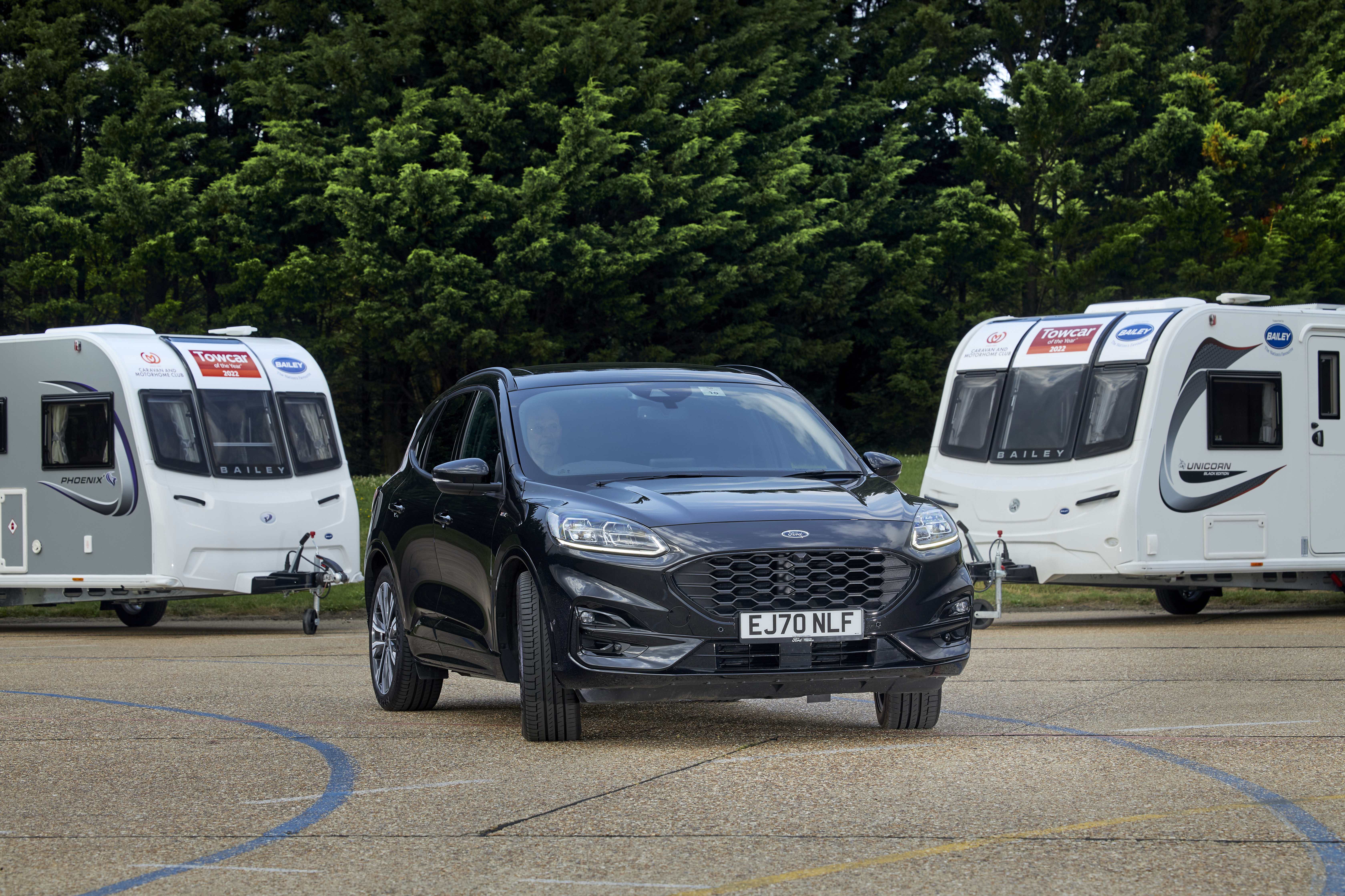

SUV, Brink detachable
Performance
  • Size of engine in cc: 2488
  • Number of gears, gearbox: 1 / Auto
  • Fuel: Petrol
  • Power (bhp@rpm): 187 @ 5500
  • Towing acceleration 0-60mph:16.05s
  • Towing acceleration 40-60mph: 8.4s
  • Towing deceleration 60mph-0: 49.0m
  • Towing deceleration 60mph-30mph: 11.1m
  • CO2 g/km: 134
Weights for towing
  • Kerbweight (kg): 1701
  • Gross vehicle (kg): 2215
  • Caravan (kg): 1446
  • Noseweight (kg): 100
Pricing
  • Price range of vehicle: £29,755 - £40,155
  • £ (price as tested) includes £891 towing gear charges: £38,936
  • Total of first three years’ car tax: £560
  • Insurance group: 20E
Read more about the Ford Kuga ST-Line X Ed 2.5 Duratec 190PS FHEV CVT

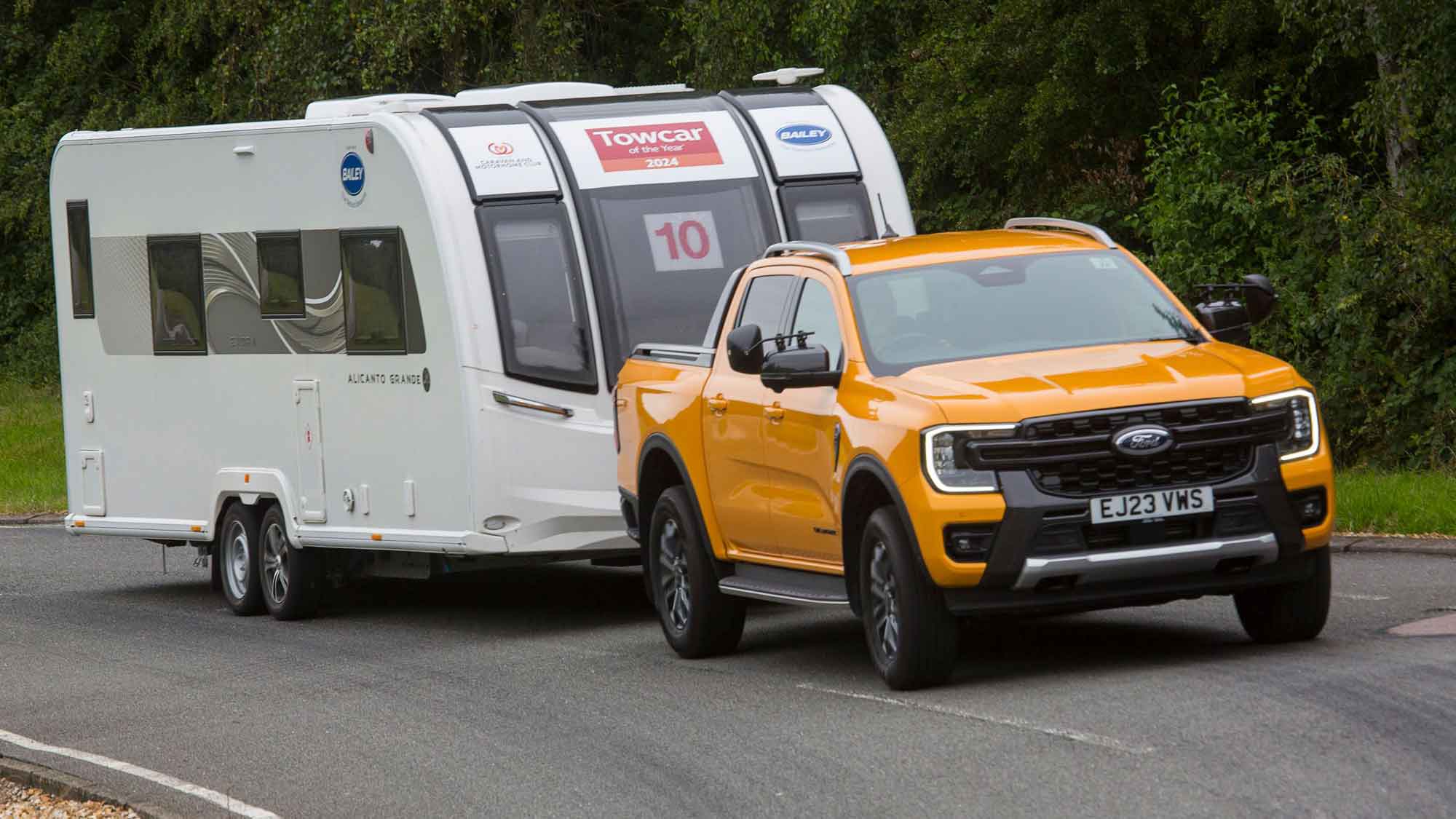

Pick up, Brink fixed
Performance
  • Size of engine in cc: 1996
  • Fuel: Diesel
  • Power (bhp@rpm): 210 @ 3500
  • Torque (lb/ft@rpm): 368 @ 1750-2000
  • Towing acceleration 0-60mph: 18.25s
  • Towing acceleration 40-60mph: 9.9s
  • Towing deceleration 60mph-0: 55.8m
  • Towing deceleration 60mph-30mph: 13.45m
  • CO2 g/km: 201
Weights for towing
  • Kerbweight (kg): 2246
  • Gross vehicle (kg): 3270
  • Caravan (kg): 1909
Pricing
  • Price range of vehicle: £30,640 - £54,940 (inclusive of VAT)
  • £ (price as tested) includes £612 towing gear charges: £46,210
  • Total of first three years’ car tax: £3,035 (CV rates will differ)
Read more about the Ford Ranger Wildtrak 2.0 213ps 10 speed Auto

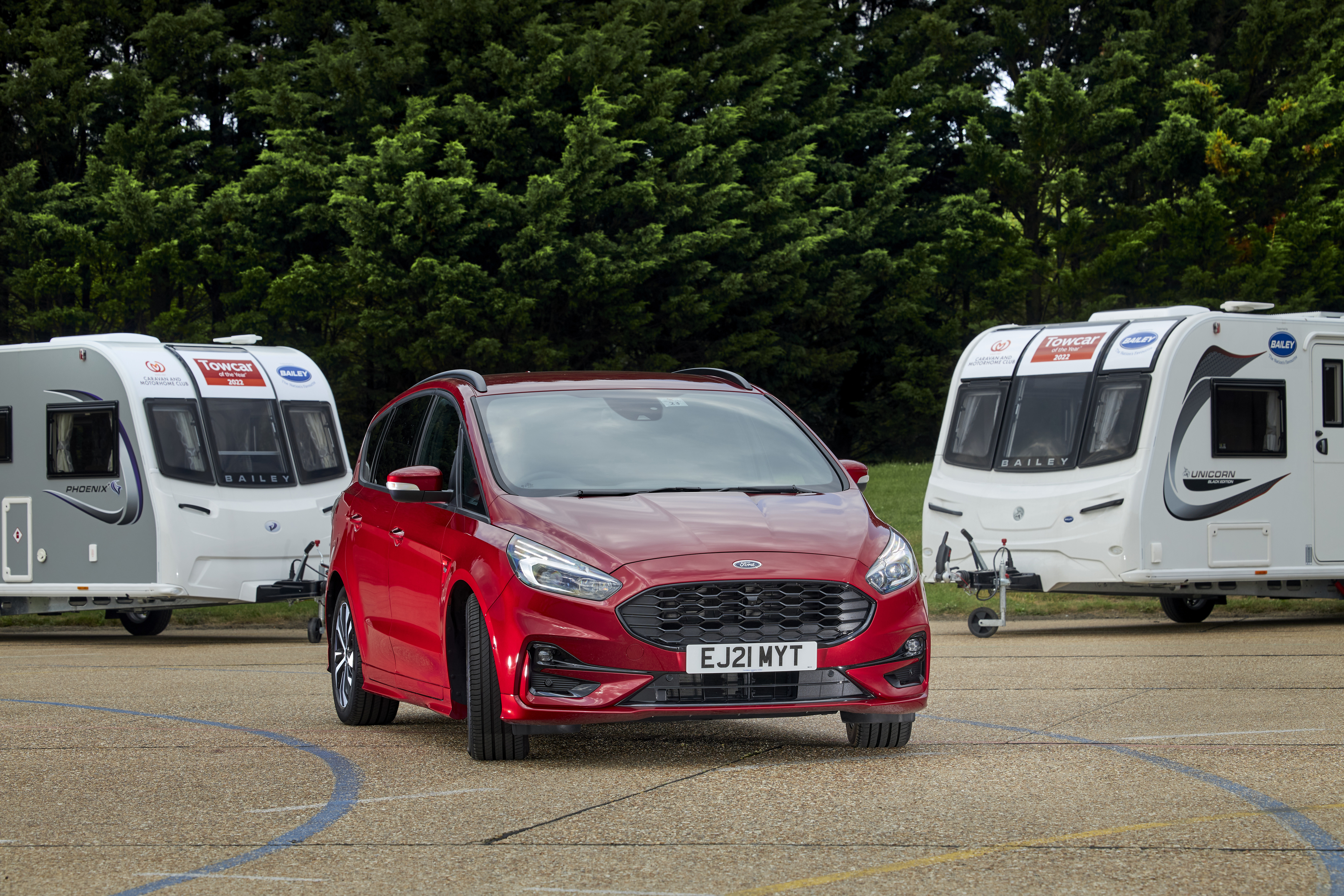

7-seater SUV, Ford retractable
Performance
  • Number of gears, gearbox: 8 / Auto
  • Fuel: Petrol
  • Power (bhp@rpm): 188 @ 4000
  • Torque (lb/ft@rpm): 400 @ 2000-2500
  • Towing acceleration 0-60mph: 17.2s
  • Towing acceleration 40-60mph: 8.9s
  • Towing deceleration 60mph-0: 56.3m
  • Towing deceleration 60mph-30mph: 13.55m
  • Fuel with mpg range solo: 43.5
  • CO2 g/km: 176
Weights for towing
  • Kerbweight (kg): 1947
  • Gross vehicle (kg): 2545
  • Caravan (kg): 1655
Pricing
  • Price range of vehicle: £33,335 - £43,010
  • £ (price as tested) includes £1245 towing gear charges: £39,885
  • Total of first three years’ car tax: £500
  • Insurance group: 22
  • Towable with B licence: B licence possible (max caravan/trailer MTPLM 955kg) but B+E required for caravan/trailer heavier than this
  • ISOFIX Mountings: Three
