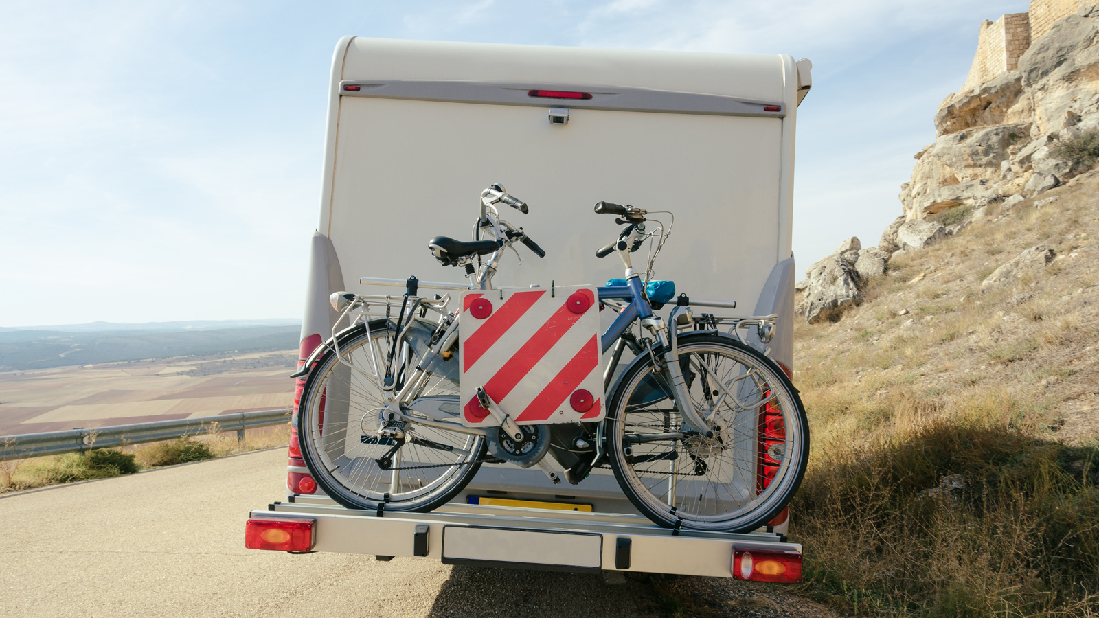

Motorhomes
If you are a motorhome owner, there is a wide selection of racks available for carrying cycles on the back. If fixing to a coach-built body, ensure the rack securing bolts will be driven into a solid framework, and not just the sandwich panel – or make sure that a suitable load-spreading plate is used inside the body. The law requires your number plate and rear lights to be clearly visible. Therefore in practically every case, a cycle carrier lighting board will be required, this plugs into your 12N road light socket or your 13-pin combined socket.

Spain and Italy have an extra requirement to display a red and white marker board if you have an overhanging load such as a cycle/motorcycle rack. Marker boards are manufactured by Fiamma (www.fiamma.it) in plastic and aluminium, and are available from caravan dealers or accessory shops. In Spain you can use either, but in Italy the marker board must be aluminium. From a safety perspective, the use of a marker board indicating an overhanging load is a sensible option in any country.
