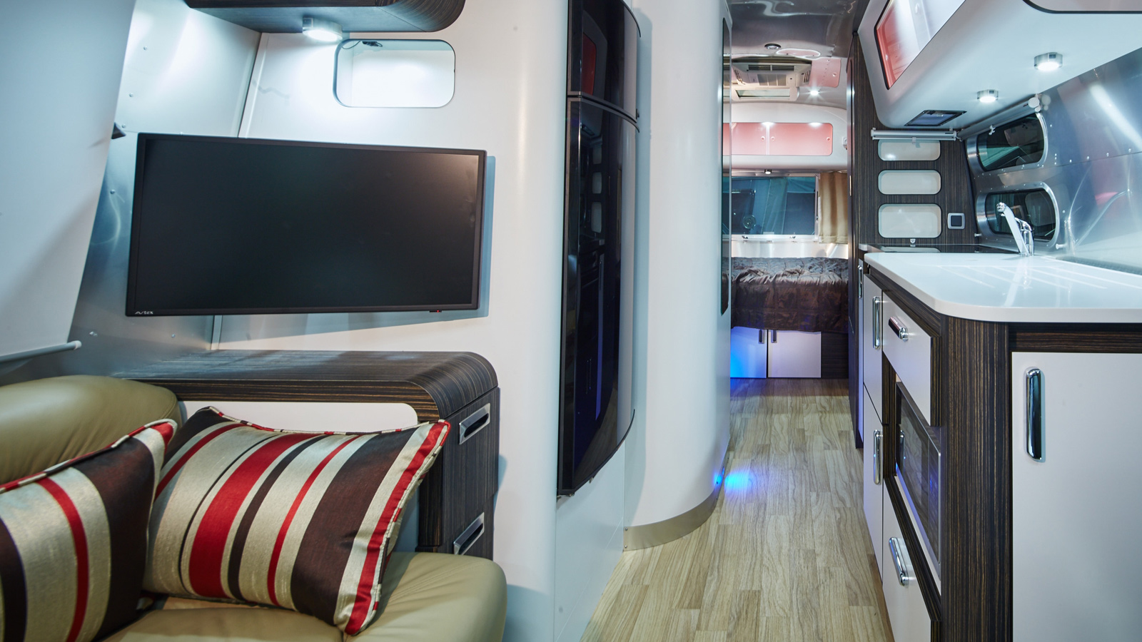

Televisions
Unless you have a particularly large caravan and lots of power available, an LCD television will probably be best for you. They use less power than older types of television and can be much more convenient to move around and store. However, they are vulnerable to damage and, if the screen should suffer a knock, it could be permanently damaged. They can also be very sensitive to voltage fluctuations so are often used with a small voltage regulator to avoid problems.
Models are available with built-in digital satellite and Freeview tuners, built-in DVD players and even with built-in card readers so that photos can be viewed on a big screen.
