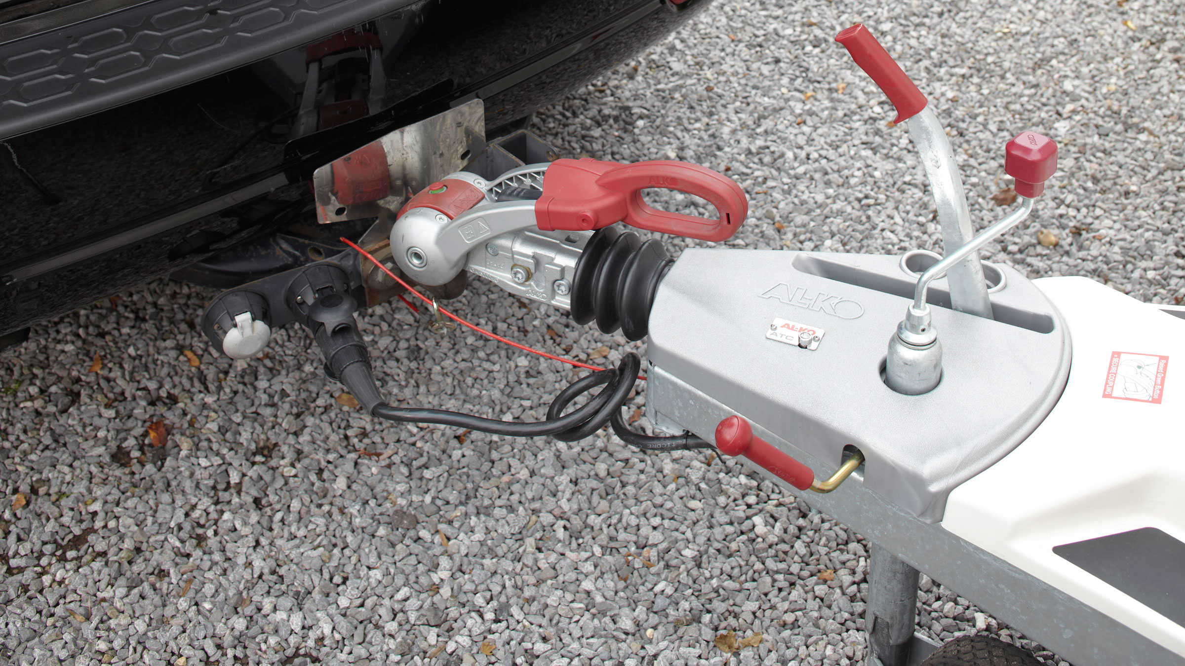

There are two main categories of trailer stabiliser: those which act both horizontally and vertically and stabilisers with lateral action only. It is the latter that are increasingly fitted as standard to most touring caravanners – usually as part of a chassis package manufactured by Al-Ko or BPW.
Their major virtues are their simplicity in operation with instant hitching up and the use of dry towballs. Once the head has engaged on the ball there are just two actions of the clamping lever. Because the clamps grip the side of the ball, damping is mainly on yaw and roll.
Most modern hitchhead stabilisers require a dry towball and use a friction material similar to that used in brake linings. Correctly set, the friction pads on all these stabilisers should have a long service life; in the case of the Al-Ko models, a lifespan of 50,000 km (31,069 miles) is claimed.
Replacement pads are available if you manage to wear them out.
All Al-Ko and BPW (Winterhoff) stabilisers have a mechanical indicator built in to show when the hitch is safely engaged over the ball and the SSK3 is similarly fitted.
