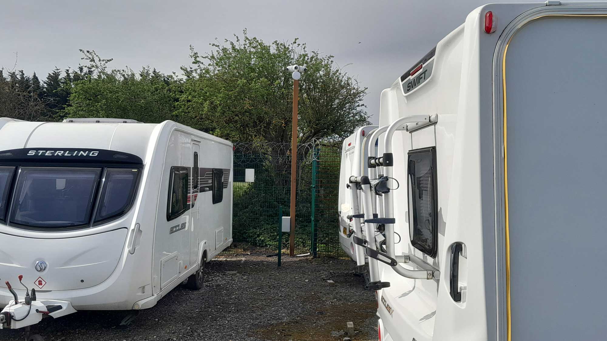

For those who were more likely to store their caravans over winter, the overwhelming piece of advice was to remember to drain down all the water - pipes, heaters, toilet flush etc. One respondent told us: “We bought a drain down kit and were amazed at the extra water we removed.”
Other key considerations that received multiple mentions were:
  • Empty the caravan of all perishable items, checking fridges and cupboards.
  • Make sure all vents are unblocked.
  • Deep clean and sanitise all surfaces, especially the kitchen area, shower and toilets.
  • Place a few dehumidifiers or moisture absorbers throughout the caravan.
  • Clean and lubricate window seal rubbers.
  • If your van’s in storage, don’t ignore it for the winter - pop back and check everything’s OK at least once a month - particularly in freezing weather.
And, if you want to start a checklist of jobs, this was one respondent’s marvellously comprehensive Must Do list.
“I keep my caravan on a storage site not far from home. When I have returned it for the winter, I empty it of all the kitchen utensils etc. and take the soft fabrics home. I take the aqua roll, the waste water and toilet tanks, plus the hosepipe for cleaning. I clean the interior and later in the storage period, I clean the exterior of the caravan. I take the leisure battery home and have it on a 'drip charger' to keep it topped up. I also do a regular check of the tyre pressures. I visit the caravan once a month to check that everything is okay, in particular after heavy bouts of rain or wind. I also keep dehumidifier tubs in the caravan and replace these on a regular basis.”
