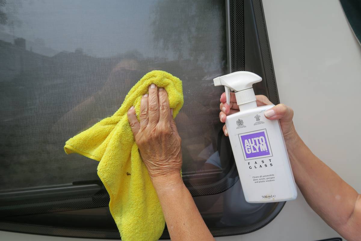

Make sure you use a specialist cleaning product to avoid damaging your windows
It is important that you use a cleaning product that is designed for use on caravan/motorhome acrylic windows – Autoglym Fast Glass (autoglym.com), Care-avan Acrylic Window Cleaner (care-avan.co.uk) and VuPlex Plastic Protection (vuplex.co.uk) are a few examples.
Always make sure you apply the cleaner using a non-abrasive microfiber or cotton cloth. I carry a bottle of window cleaner on my trips, so, after arriving on pitch, I can give the windows a good clean. Voilà – I can see clearly now the bugs have gone!
Note: Don’t use methylated spirit to clean your acrylic windows as it will cause cracking or ‘crazing’.

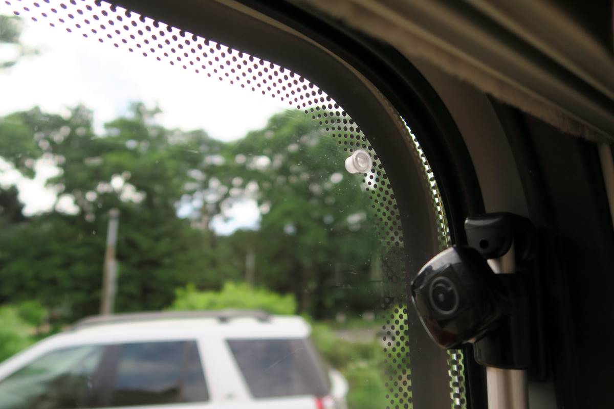

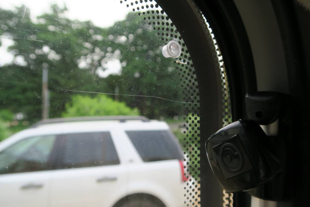

Before (left) and after (right) removing a light scratch using our simple tips
First, a quick tip – if you use a caravan/motorhome cover, wash your vehicle before putting it on. This lowers the risk of dirt and grit becoming trapped and further damaging your windows.
There are products on the market that you can use to tackle light scratches on acrylic windows. One example is Fenwick’s Windowize (fenwicks.info). Here’s how to get the best results...
  • Remove as much dirt, grime and dust as you can before applying Fenwick’s Windowize
  • Shake the bottle and apply to a soft cotton cloth
  • Apply using a circular motion with a little pressure, enough to remove the scratch
  • Wipe away using a microfibre cloth
The results can be truly impressive but deeper scratches may require complete window replacement.
