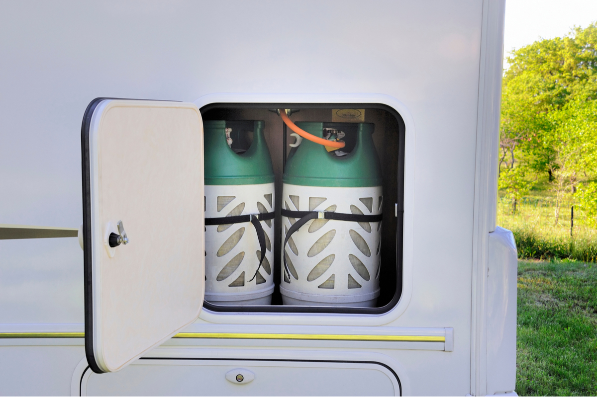

As key gas connection in your caravan or motorhome, the pigtail hose needs looking after. The average lifespan of a pigtail fitting is between 3–5 years as the rubber naturally degrades, meaning regular replacements are needed. Upgrade to Truma’s Reinforced Pigtail Hose and relax for a little longer knowing that it is designed to last for seven years.

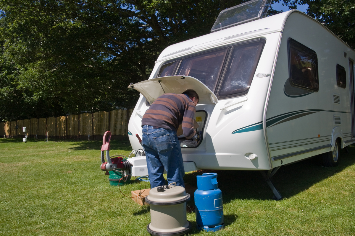

Always follow site safety protocols and guidelines when camping. Visit the Gas Safe Register for gas safety tips from the professions.
For your own safety and that of others, your leisure vehicle gas system should be professionally serviced and maintained. Alongside such attention though, it’s always worth giving your system a visual check and functional test from time to time, especially if it hasn't been used for a while. If anything needs upgrading or replacing you can find a range of products at the Club Shop but if you have any doubt over your competency to fit these, we suggest you seek professional help.
