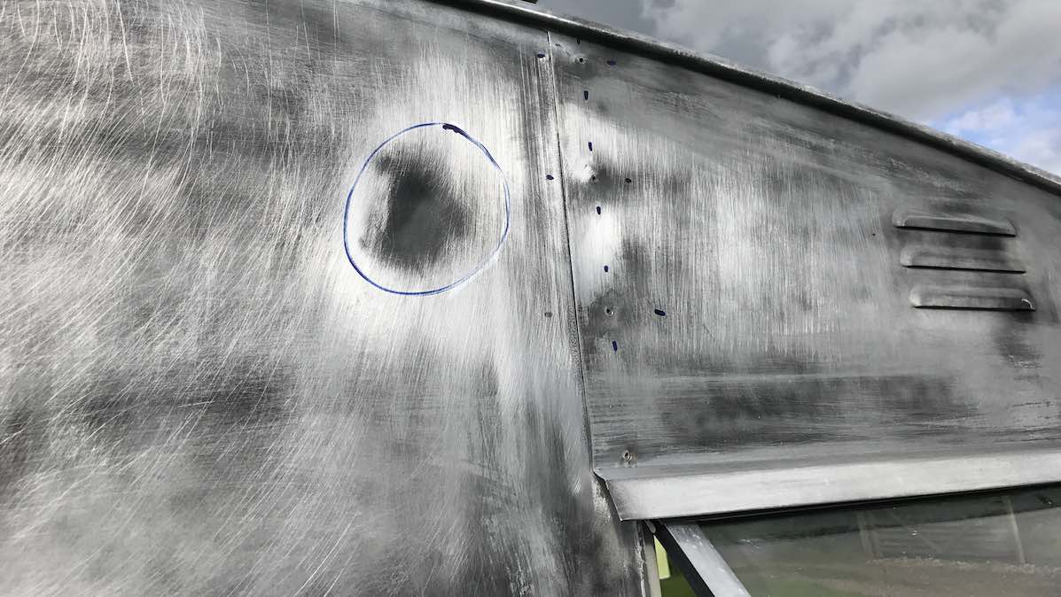

The wooden battens behind the awning rails were removed and replaced, and with fresh woodwork in place, paint, corroded material and rock-hard sealant were painstakingly removed with a wire brush on a drill. With sparkling aluminium to both sides, a modern sealant was applied and new fixings used. Aluminium beads seal exterior joints and these received the same treatment, along with the window frames.

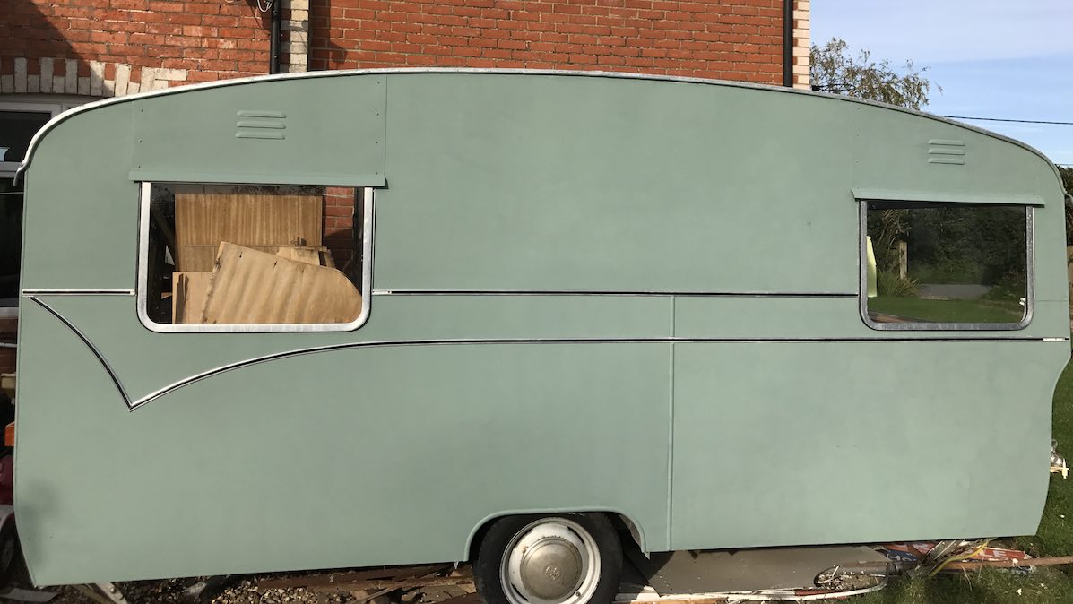

Paintwork
Bailey, which continues to manufacture caravans at the same Bristol site where our 1967 Maestro began its life, informed me that tourers were hand-painted in coach enamel at that time. Having a caravan sprayed can be incredibly expensive and I’m thankful that keeping things authentic actually kept costs down. All I needed was a YouTube tutorial, a gloss roller and a decent brush to ‘lay off’ the coach enamel.
We stripped layers of untidy paintwork from the body until fresh metal was found, before etch priming and priming. We practised applying the topcoat on small areas before treating 'Gladys' (as she was now called) to a complete fresh coat of enamel.

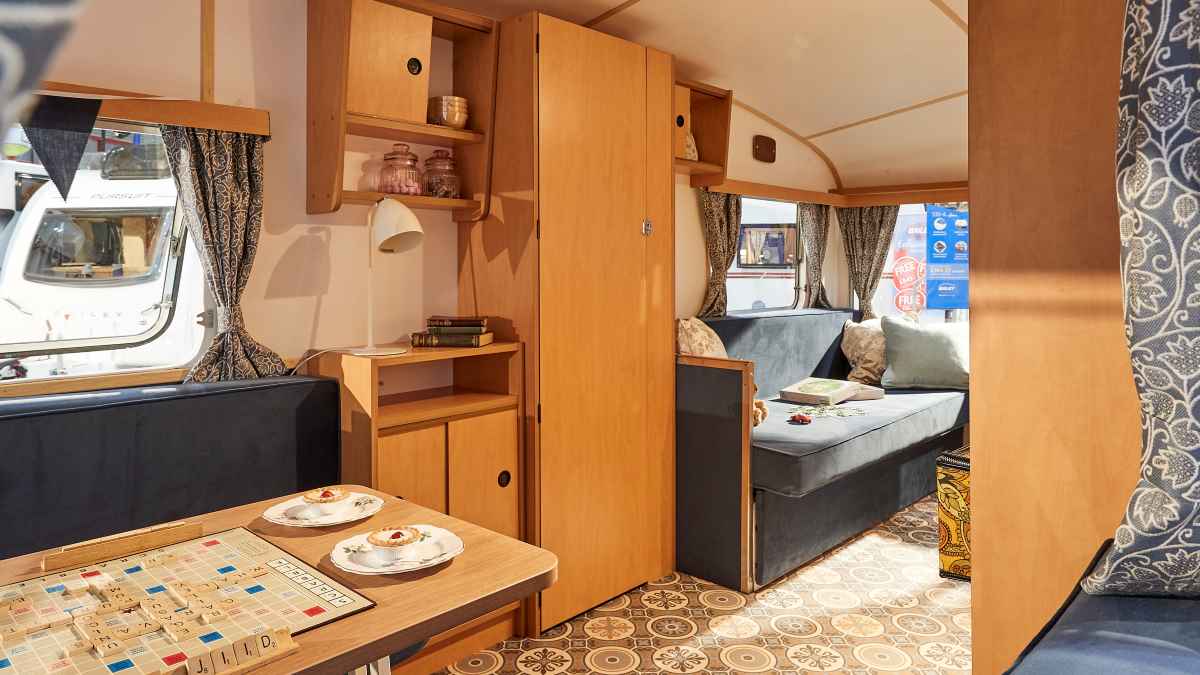

With new 3mm boards lining the ceiling and walls, and a square of lino covering the floor, the smell of mould was gradually subsiding. My sister-in-law was making new cushions and curtains which gave me time to tackle the fixtures and fittings.
The fallen tree had sadly channelled rainwater into the kitchen, which had taken its toll on this area. However, it’s possible to match original woodwork fairly well and we were able to blend new components with those that had been fitted in Bristol in the Sixties.
I thought the interior would be a quick dash to the finish but it proved to be quite a lengthy process that was hindered by a multitude of small, niggly jobs.

Having spent two decades in a hedge before Charlie and I rescued her, Gladys was in a bad way – a tree had fallen on the roof, stretching a small section of aluminium. A flexible 100W solar panel covered this perfectly and allowed us to run an amazingly efficient Dometic compressor fridge/freezer, which is hidden in the wardrobe. LED lighting lies behind George and Mildred-style lampshades, and various USB points are tucked away. We also have a complete 240V system distributed inside via C-Line sockets from Prima Leisure.

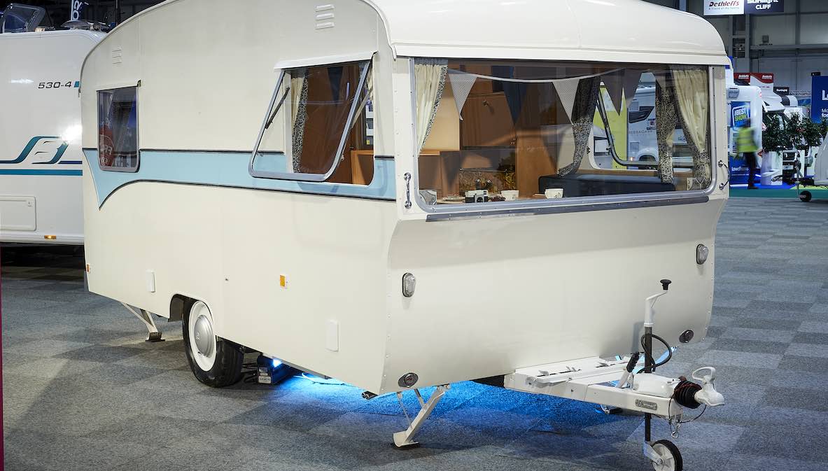

The finished article
Time was our biggest outlay, something that we had hugely underestimated. Roofing battens proved cost-effective with 25mm x 50mm lengths cut down the middle, and new 3mm ply came via a builder’s merchant.
Such a project can appear intimidating, but split into small, bite-sized chunks, it’s a relatively straightforward and immensely satisfying process. If Charlie and I can do it, anyone can!
