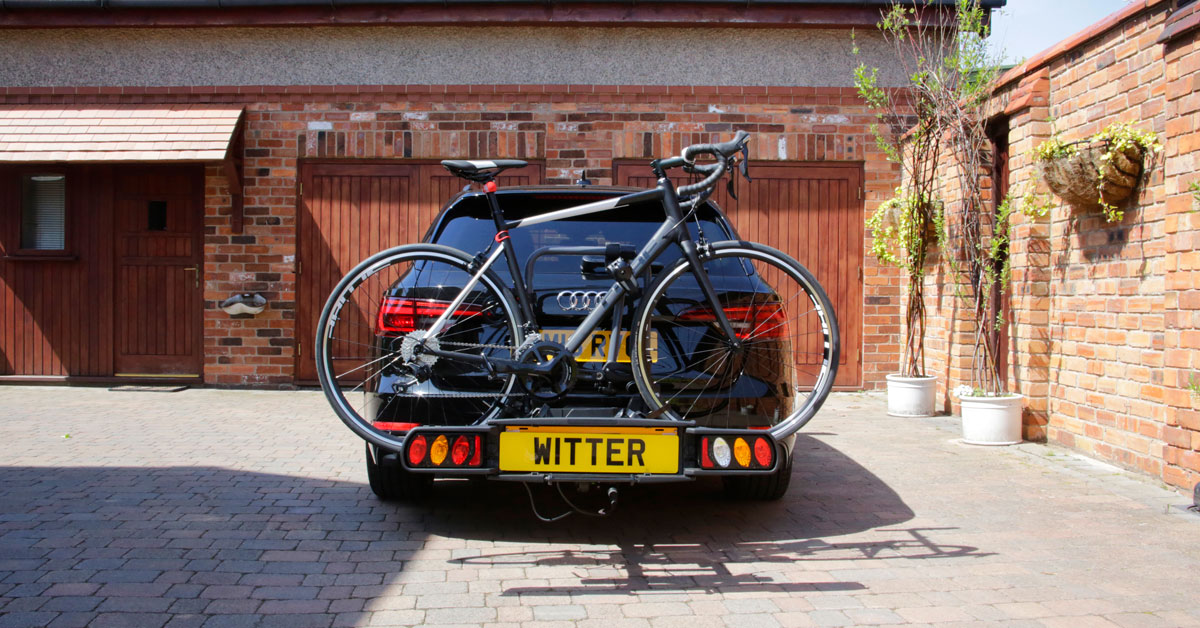

Towbar-mounted carrier: Those clamping to the towball aren’t any use when towing, but those fitted behind a bolt-on towball are stable and secure. Weight of rack and bikes adds to noseweight though, so it’s not ideal unless your car has some excess noseweight capacity.

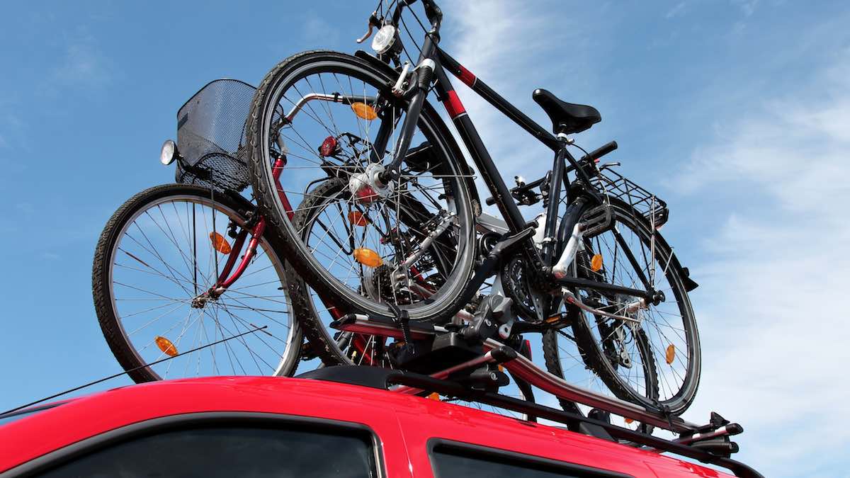

Roof rack-mounted carrier: It is harder to get bikes on and off these. They generate more noise than the other options and harm fuel consumption.

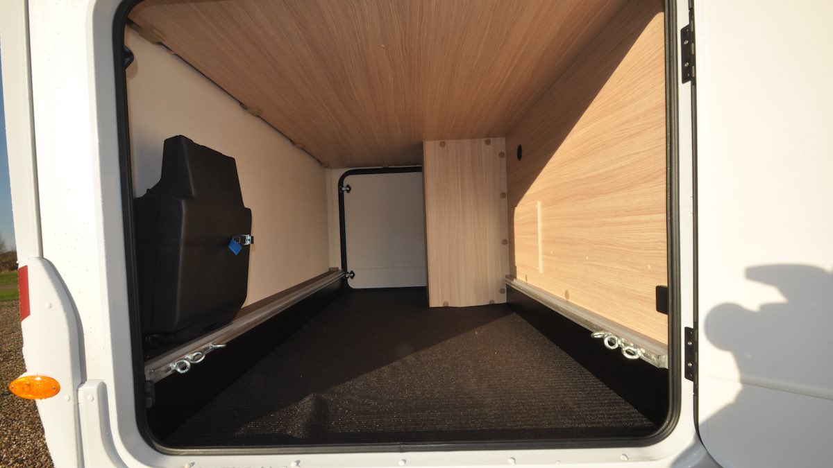

Inside vehicle: Sometimes viable even in smaller campervans, while larger motorhomes might have a rear garage, which is ideal – although watch your payload capacity if you fill it up.
