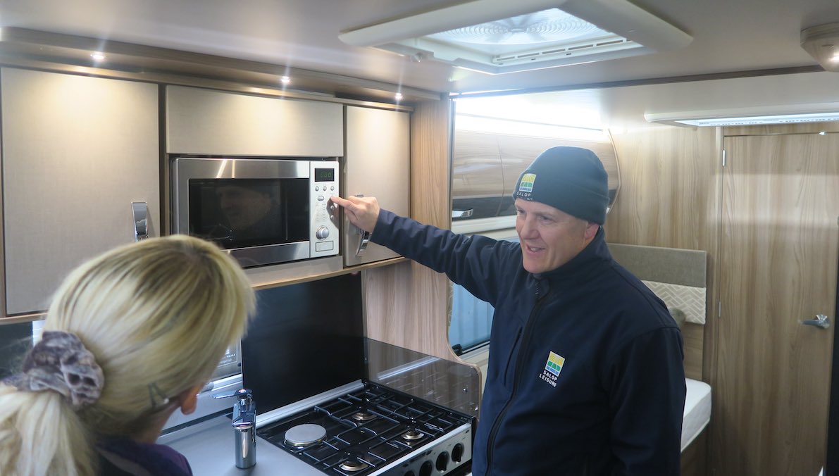

Caravan dealer showing how to use a microwaveMake sure you understand how to operate all the appliances
Interior
It was a welcome relief to retreat to the inside of the caravan on such a cold, gloomy day, where we were introduced to the efficient Alde heating system and effective LED lighting.
We were already used to most procedures, such as how to use the microwave and oven, how to make up the beds, how to operate the equipment in the washroom, etc. However, if you are new to caravanning/motorhoming, do not feel embarrassed about asking questions. Believe me, some motorhome bed set-ups are like jigsaw puzzles!
We certainly needed more extensive explanations for the Swift Command/Alde control panels. Pete
went into great detail as he steered us through the on-screen ‘menus’ – thank goodness we had it all recorded on video, as there was a lot of information to take in.

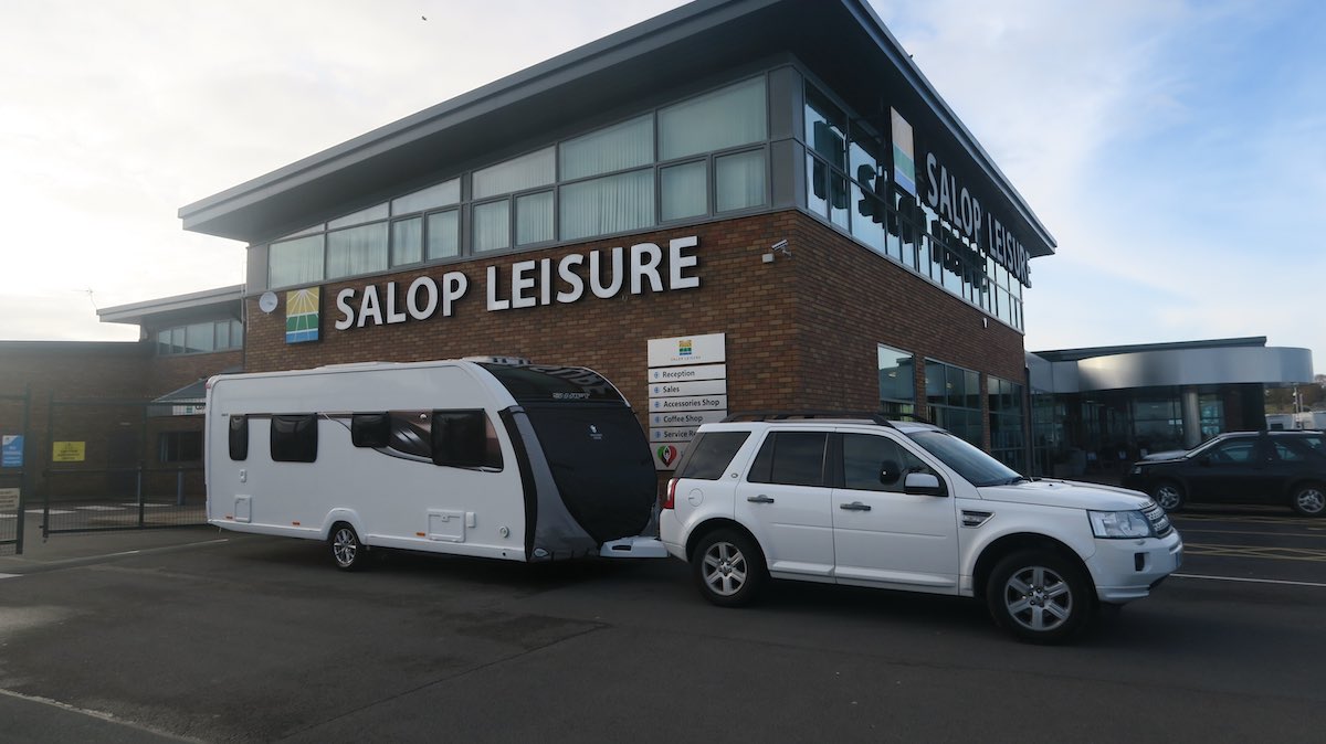

Next on the agenda is to hitch up and do some final road light checks. Unfortunately our Land Rover didn’t recognise the Swift’s LED rear light clusters, so Salop Leisure fitted a device that sorted the issue.
Finally, the time had come to transfer everything out of our Bailey and into our new ’van. I’m not going to lie, it was emotional, as we have so many great memories of touring in it.
4x4 towing caravan outside Salop Leisure depotReady for the off (we had purchased our towing cover in advance)
