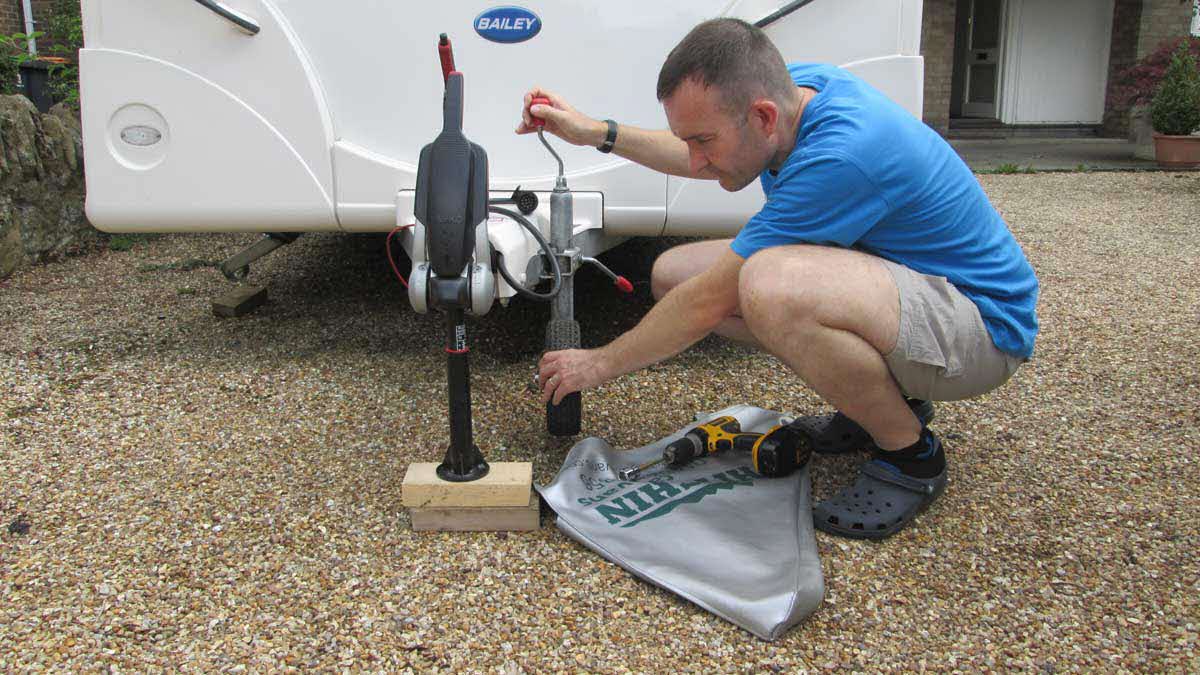

Noseweight is the downward force on the tow ball. Correct noseweight improves towing stability and reduces the risk of snaking. Always check before leaving home/pitch.

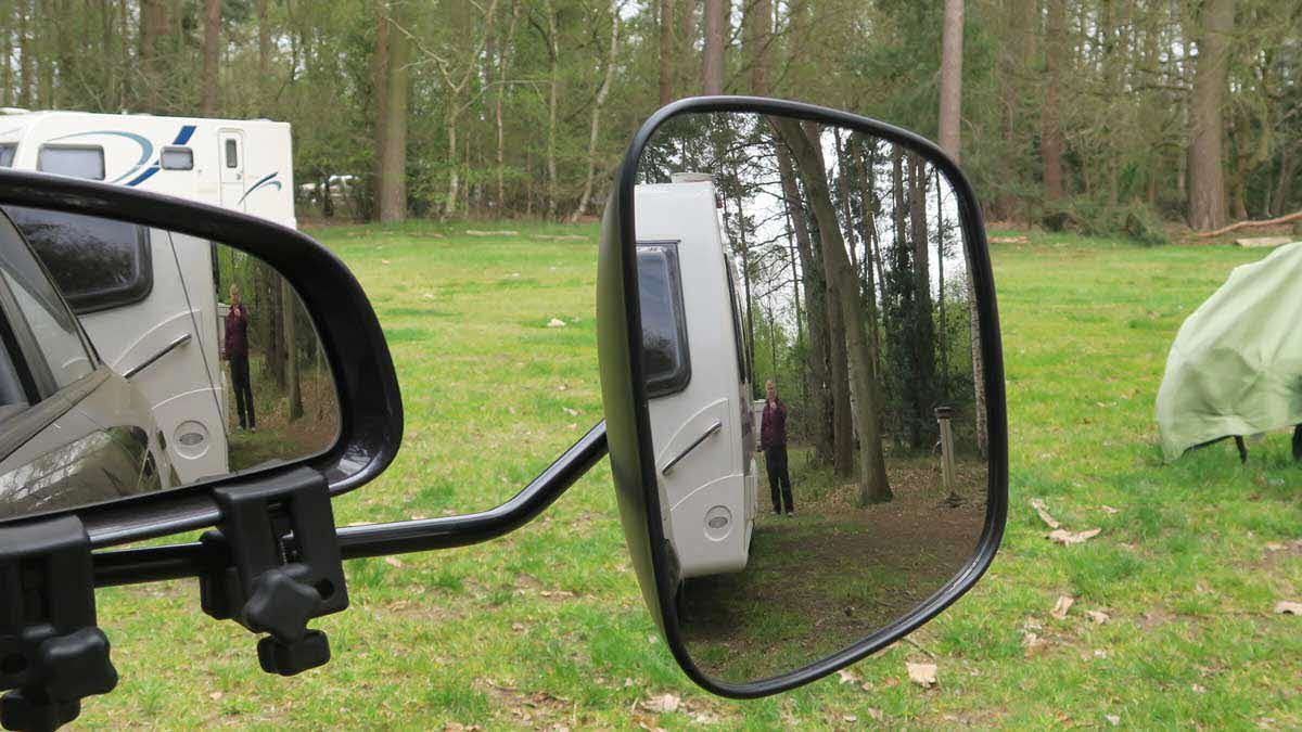

When towing, visibility is key. You must be able to see clearly 4 metres to either side and 20 metres behind the caravan. This typically means fitting towing mirrors, which are a legal requirement and not just a nice-to-have.

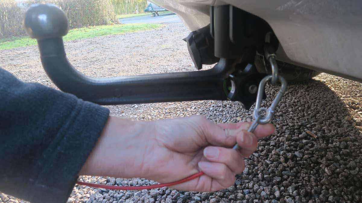

In the unlikely event that your caravan detaches from the tow car, a correctly fitted breakaway cable is designed to activate the caravan’s brakes, bringing it to a controlled stop rather than letting it roll freely and dangerously. It must be securely attached to a dedicated anchor point on the towbar or looped once around the tow ball if no attachment point is available - but never attach it to the electrics.

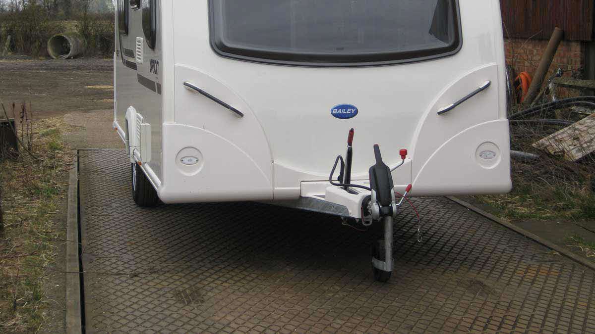

  • Safe use of the jockey wheel and coupling procedure

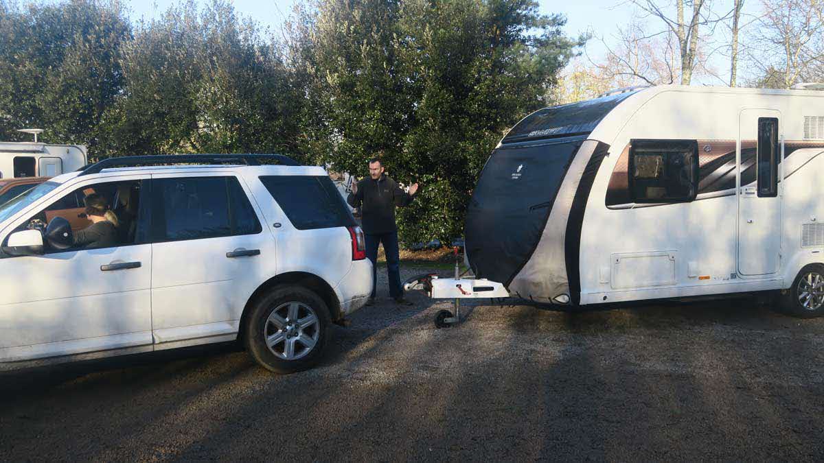

Practical sessions also cover key manoeuvres like reversing, using mirrors effectively, and practicing pre-arranged hand signals with a partner. What’s more, the Caravan and Motorhome Club provides the caravans, so you can focus on learning without worrying about your own kit.
