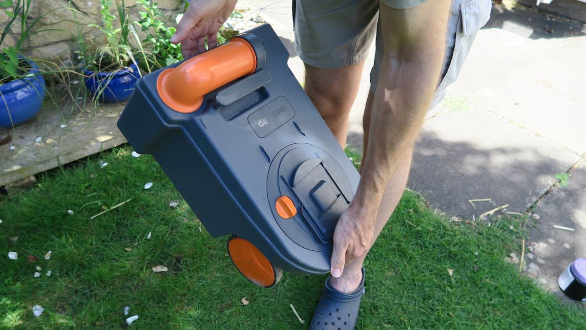

For some campers, using the on-board facilities has never been more important, and that means emptying the toilet cassette. One important thing you mustn’t do when rinsing through the cassette is to shake it up and down – vigorous shaking may dislodge the internal magnet that identifies when it is full. Instead, gently shake it from side to side.
Gently shake the toilet cassette from side to side – not up and down – when rinsing it out

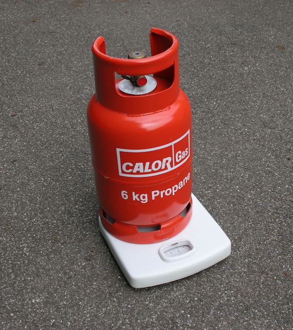

Running out of gas is not something you want to do – especially if you are staying on a basic site. The Club’s Sites Directory & Handbook contains a handy table detailing the weights and sizes of liquefied petroleum gas cylinders as supplied by major brands (p610). Using this table, you can work out how much gas you have remaining by regularly re-weighing your cylinder after use. Alternatively, weigh your cylinder when it is new and then on scales as it gets used. There are other, more sophisticated ways of measuring how much gas you have left – the Truma LevelControl system, for example, can send information directly to your mobile phone.
You can weigh your gas cylinder with bathroom scales                          Only use specialist leisure vehicle cleaning products

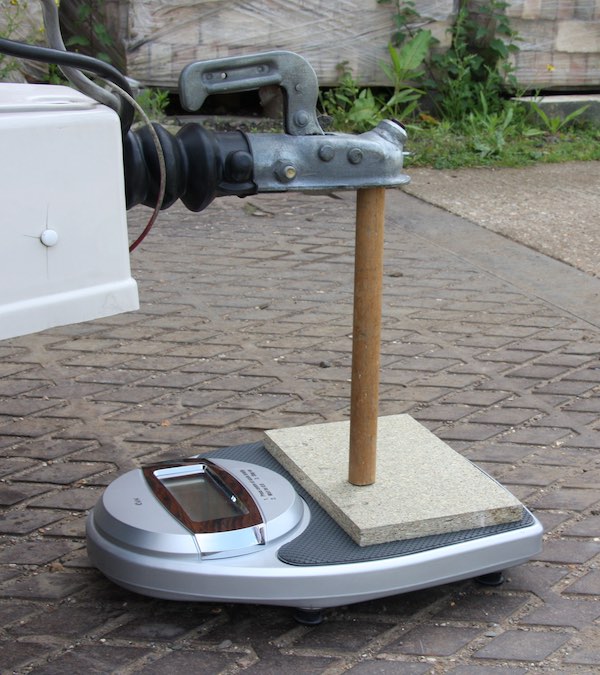

Another term you need to be aware of is ‘noseweight’. This is the downward force of a caravan’s coupling head on a car’s towball, and it’s an important element to consider when choosing a towbar. The general recommended noseweight for towing stability is 5-7% of your caravan’s laden weight – provided that figure doesn’t exceed either the car maker’s limit or the towbar’s limit. If you don’t own a noseweight gauge, then a set of bathroom scales and a cut-off broom handle will do the job.
Improvise if you don't own a noseweight gauge                                     Always check your tyre pressures before setting off

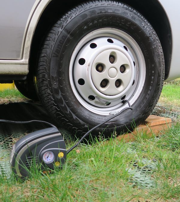

Before setting off with a caravan, check the pressure of the caravan’s tyres and its wheel torques. The owner’s manual or data plate on the side of the van should provide the necessary details. Make sure you take pressure readings when the tyres are cold. It is also advisable to check motorhome, campervan and car tyre pressures before departing.
