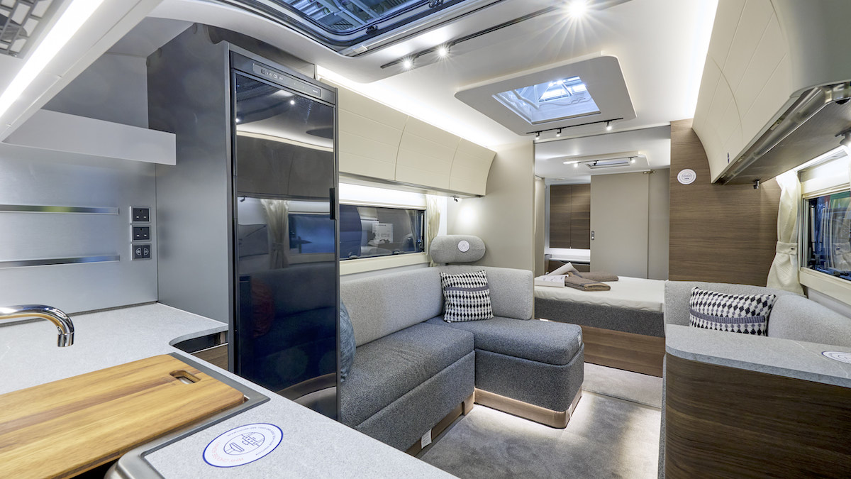

Types of fridge
Sleek and sophisticated, but not quite like your domestic fridge
Fridges use two different technologies:

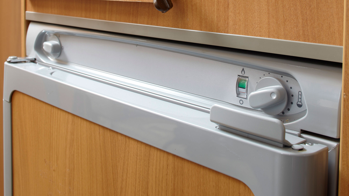

  • Absorption: these tend to be fitted to larger vehicles and are usually powered by 12V from battery or towing vehicle, 230V from site hook-up, or LPG.
  • Compressor: 12V, running either directly from a battery, perhaps also with solar panel(s), or indirectly from the mains via a 12V power supply.
Compressor fridges are efficient, cooling quickly and staying cool very effectively. They tend to make a little noise and usage off-grid needs some consideration of power management.
Absorption fridges suit on- and off-grid (via gas) usage. They’re quiet and on mains or gas tend to be relatively powerful. However, they’re less efficient and may struggle to keep cold in high ambient temperatures.
This latter point’s worth considering. All fridges can reduce temperature by a certain amount, though not necessarily to a certain level. So as outside temperature increases, their ability to achieve low temperatures diminishes. Compressor fridges often seem rated for effective use in higher ambient temperatures than absorption ones, although clearly they’ll then use more power to stay cold.
Until relatively recently, larger fridges have tended to be absorption. Large compressor fridges are now available, which combined with better (eg lithium) battery technology and solar panel fitment, means we’re likely to see their wider use in coming years.

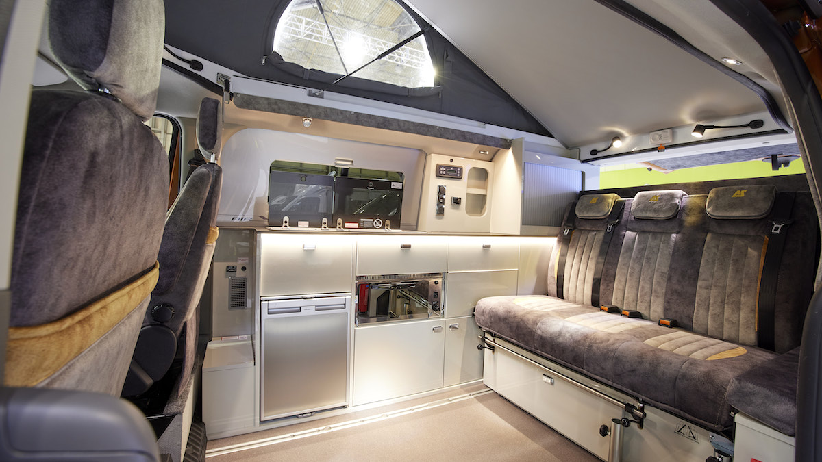

Smaller vehicles like campervans have tended to use compressor fridges
