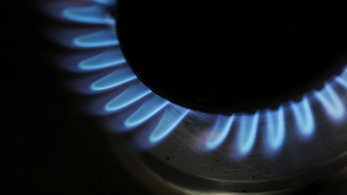

  • Check for common signs of a poorly-functioning system – eg lazy yellow/orange flames instead of crisp blue ones or sooty black marks on or around an appliance. Get it checked out professionally!
