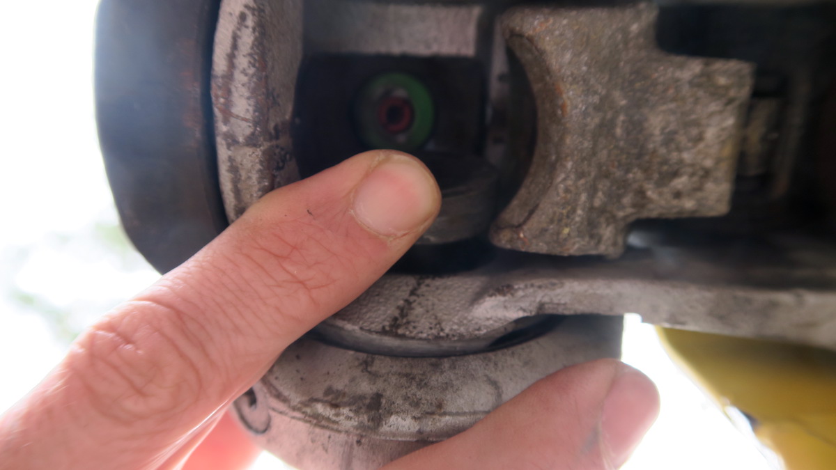

Sometimes you may get a grinding or creaking noise coming from your hitch when towing, particularly around corners. This is often the result of dirty or worn stabiliser friction pads, which need cleaning or replacing. This is a relatively simple task.

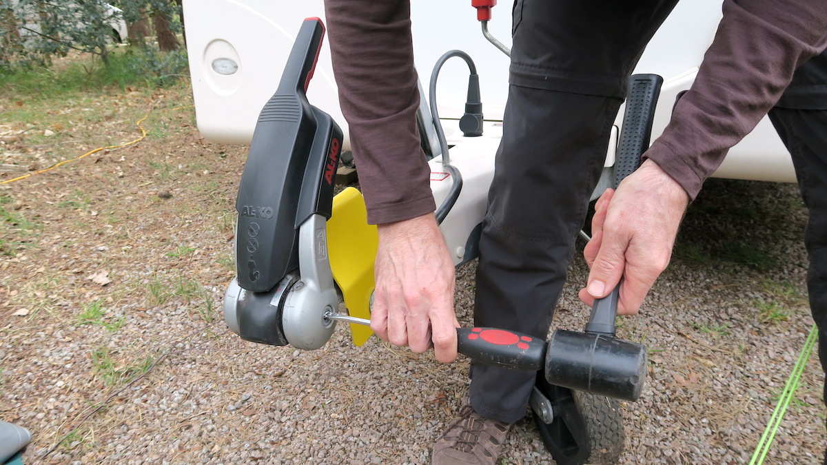

The  following steps relate to an Al-Ko AKS 3004 stabiliser coupling:
  • Step 1: Using a flat bladed screwdriver, remove the caps on both sides of the stabiliser. You should be able to see the rear of the stabiliser pads.
  • Step 2: Place the screwdriver in the hole and gently tap the end to remove the friction pad. It should just drop out, so make sure you are ready to catch it, particularly if you are planning on using it again. Occasionally, there may be a washer or shim that is attached to the friction pad, so don’t forget to put this back when replacing.
  • Step 3: Assess the condition of the friction pad. Dirt and other contaminants can cause friction pads to become shiny, hindering their ability to grip the towball. If it is in reasonable condition, give it a clean using emery cloth.
  • Step 4: Re-insert the cleaned friction pad or a new pad. Remember, if there was a shim on the old pad, reattach it. An AKS 3004 friction pad kit costs about £38 from ukshop.alko-tech.com (but you may find one for less if you shop around).
