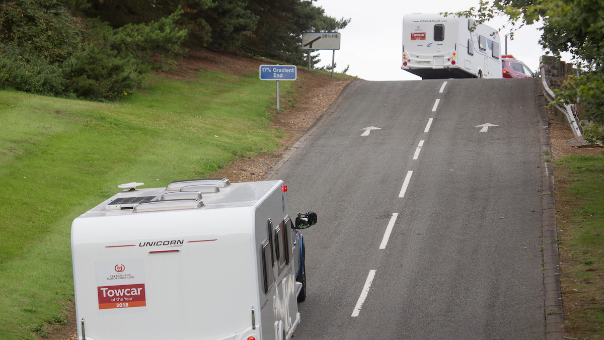

We test hill starting capability during the Club’s Towcar of the Year awards but, to minimise fuel usage, you should avoid it whenever possible.
