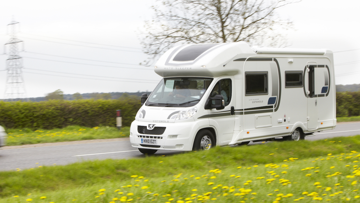

Motorhomes
This is where things get a little complicated, as the rules are based on the unladen weight of the vehicle – something which not all owners will know. The definition of unladen weight used in this context is the weight of the vehicle when it’s not carrying any passengers, goods or other items, and without fuel. Most vehicle manufacturers quote a kerbweight definition which usually includes 75kg allowance for the driver and the weight of fuel – that’s typically about 150kg more than the unladen weight.
Some motorhome converters are reluctant to quote such weights, though, saying it depends on the individual vehicle specification. That makes it hard to know your payload allowance and potentially your speed limit too.
If the unladen weight of your motorhome is not more than 3.05 tonnes, the same limits apply as for solo cars, ie 60mph on derestricted single carriageway roads and 70mph on derestricted dual carriageways and motorways.
However, if the unladen weight of your motorhome exceeds 3.05 tonnes, the limits are 50mph for single carriageways, 60mph for dual carriageways but 70mph for motorways.
