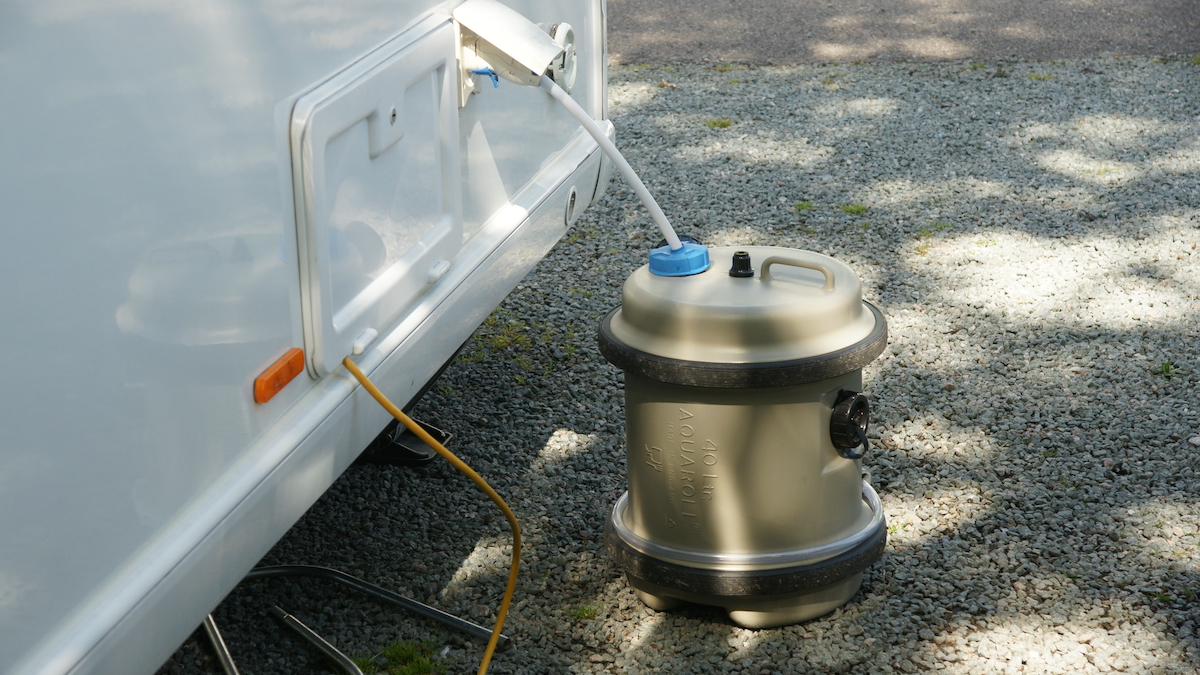

Don’t forget to include external fresh water containers and connecting/filling hoses in your sterilisation routine
