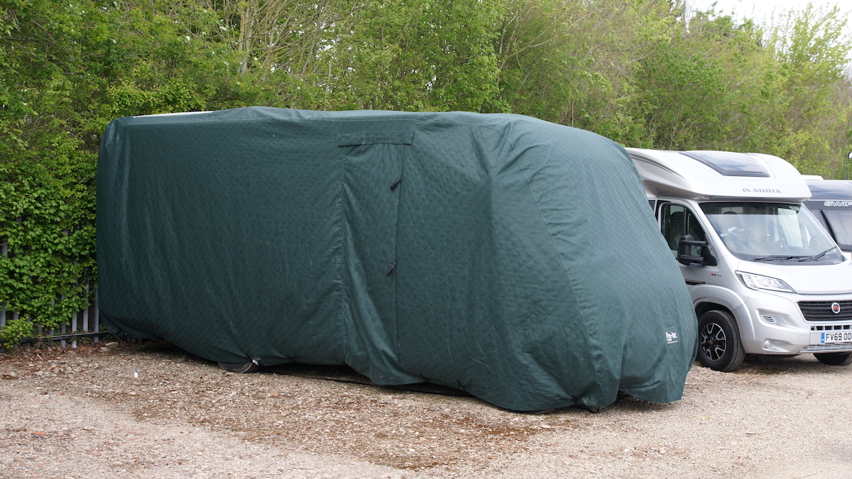

A breathable cover will protect your vehicle and reduce the amount of cleaning required when you begin touring again

  • A good, breathable cover will protect the vehicle and reduce spring cleaning requirements.
