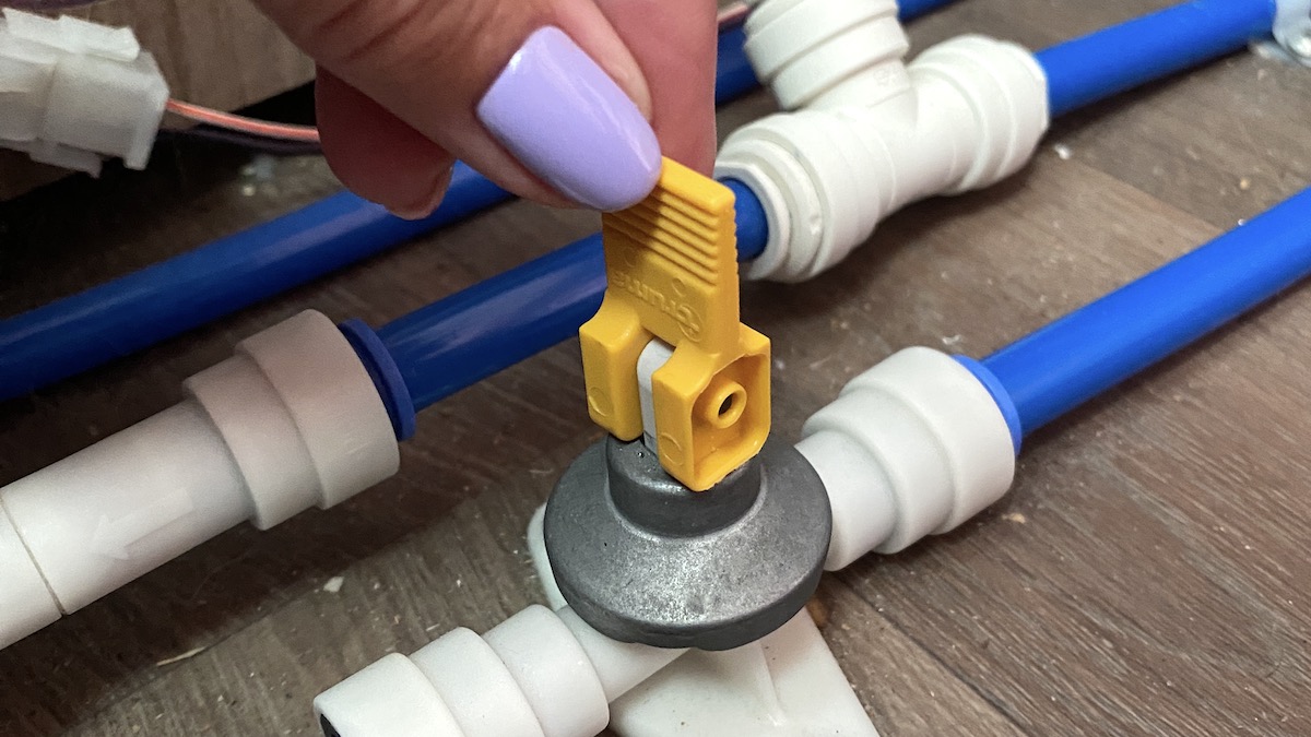

Britain often experiences temperatures below 0°C (32°F) in winter, which means frozen water in the water system can be a problem. When we return from our travels there will usually be water left in the water heater and toilet flush tank, as well as some sloshing around in the pipes. As water freezes it expands and this may result in pipes splitting, rubber seals snapping and damage to taps and tanks.
To avoid this happening, simply drain down the water system. Starting with the water heater, set the drain-down lever (which is usually yellow) to the open position. In the kitchen, open the tap to the middle position (if it is a mixer tap) and turn on the pump. Leave the pump running until water no longer flows from the tap. Repeat this exercise with the washroom tap and shower. When complete, turn the pump off and leave the taps open in the middle position. Finally, place plugs in all the plugholes to prevent nasty smells (or bugs) coming up the pipes and infiltrating the living space.
Some motorhomes and caravans contain an onboard fresh/waste water tank so ensure that the tank drain is in the open position.

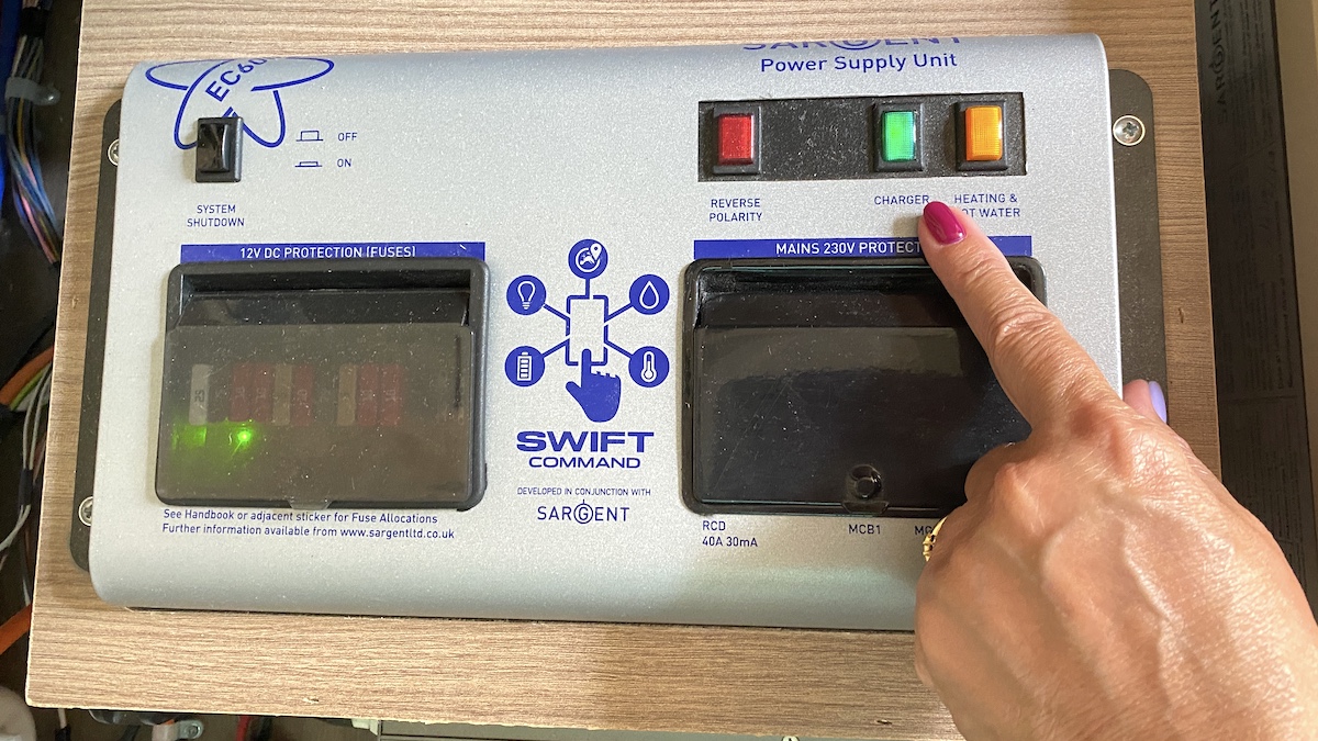

Electricity
If your outfit is being stored while connected to a 230V mains supply, then ensure that the leisure battery is connected, but be aware that unless you are running appliances in it, the battery doesn’t really need to be on charge continuously – switch it on for a few hours every now and again, or use a time switch. Make sure the internal switch settings are set correctly. Check the handbook for definitive instructions, but generally, turn the isolator switch on the Power Supply Unit (sometimes called a Consumer Unit) to the ‘on’ position; however, the control panel should be switched off. Check that the light is on for the charger, which will maintain your leisure battery.
If the vehicle is not connected to a 230V mains supply, then ensure the isolator switch on the Power Supply Unit is in the ‘off’ position. The leisure battery will eventually drain if trackers or alarms are fitted, so make sure you regularly check its status. A solar panel can provide an alternative power source and can extend the time between leisure battery recharges.
I tested Milenco’s Solar Charge by OptiMate pulse charge system over winter, monitoring my leisure battery’s status throughout, and it successfully maintained the battery without the need for a mains supply. The long charging lead ran from my roof-top solar panel down to the battery box connection.
If you do not have trackers or alarms then it is possible to remove the leisure battery and keep it topped up at home.
