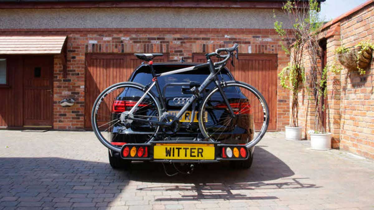

Designs of bike carriers vary in terms of how high you need to lift the bikes. Unless the racks are high-mounted, you’ll need a lighting board with your car’s registration number on, in case the rack or the bike obscure the car’s lights or number plate. These can often be the most cost-effective racks.
Towbar mounted carrier:
Those clamping to the towball aren't of any use when towing but if you’re fitting behind a bolt-on towball, this would be more stable and secure. Be warned though, the weight of the rack and the bikes do add to the noseweight, so it’s not ideal unless your car has some excess noseweight capacity.

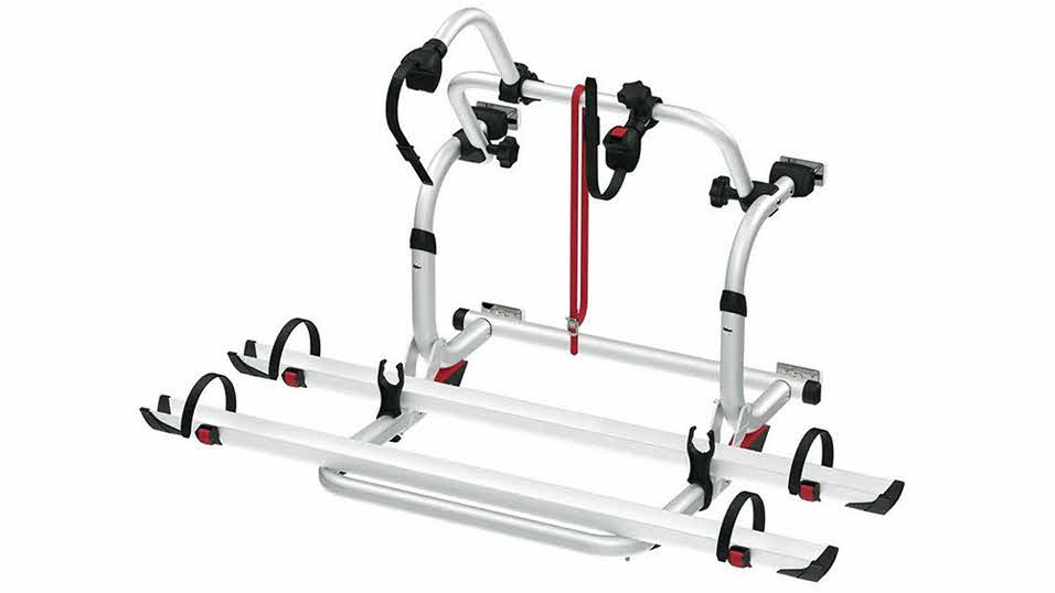

Do remember to think about your storage that you’ve got available at home, when you’re back from touring. Does the removable rack fold or dismantle or will it take up quite a bit of space in your garage or shed? Visit our Club Shop to get discounted member rates on bike racks like the Fiamma Carry Bike Pro C Cycle rack (below) RRP £713.96, Club Shop price £642.56, which as a member saves you £71.40.
