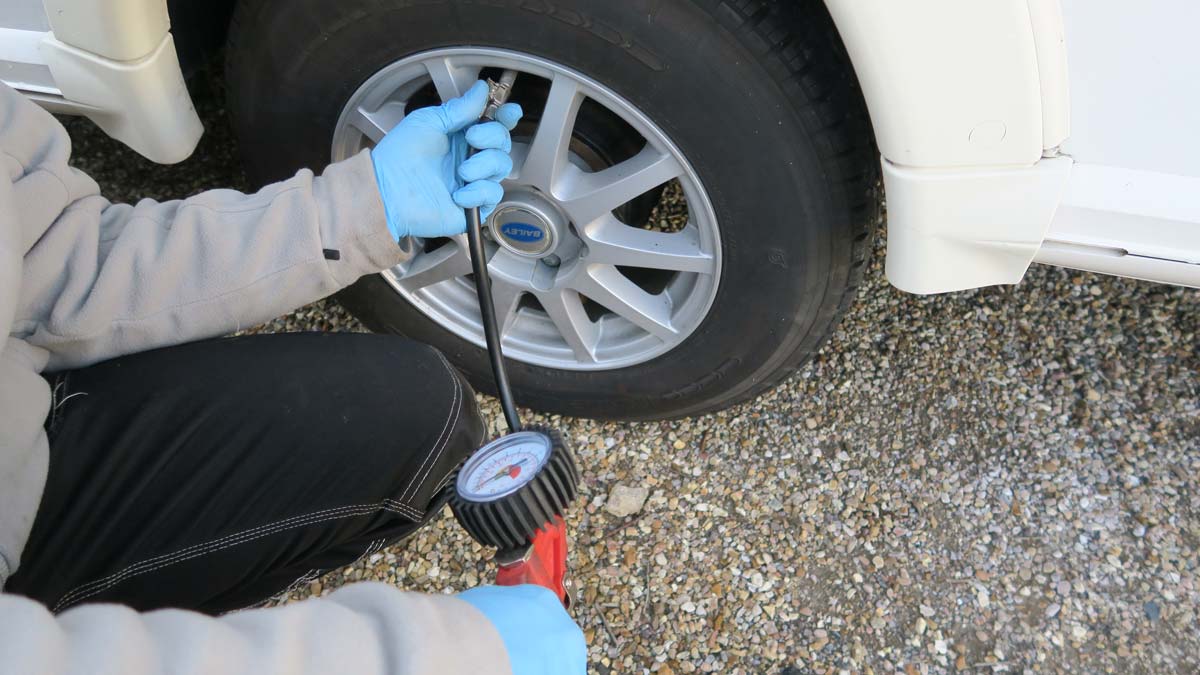

  • Tyres (pressure, condition including wear, deformation and tread depth) and wheel fixings (correct torque setting)
