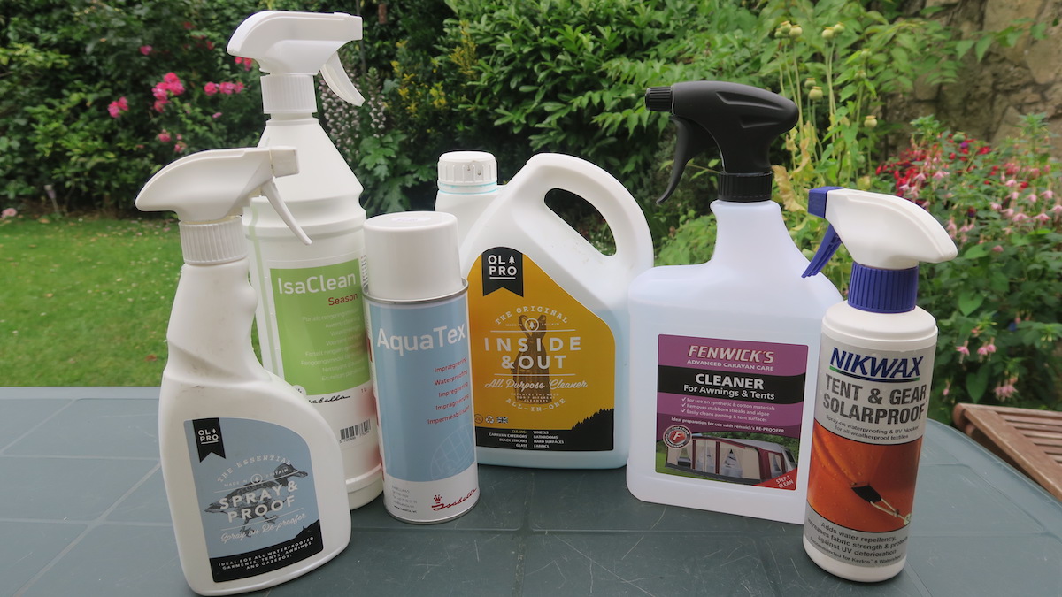

Awning fabric can be sensitive to domestic soap powders and cleaning detergents, so it is advisable to use specialist cleaners. Some awning manufacturers recommend simply cleaning with warm water and a soft brush.
THE CLEANING PROCESS
The cleaning process can vary from product to product. For the purposes of this article, I will be focusing on how we clean our Isabella awning using an intensive cleaning product – IsaClean Season – which is intended for use on very dirty canvas.

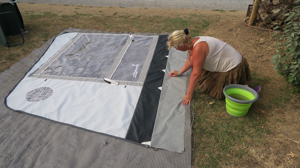

Be careful when cleaning plastic windows on awnings as they can be damaged easily. Look out for specific awning window cleaning products, like IsaClean Window. If in doubt, just use warm water and a microfibre cloth. It is also important to clean the skirt and draught skirt as they tend to get quite muddy, particularly during wet periods. We always try to do this before we leave a site (if the weather allows), as mud left in situ can cause stains.

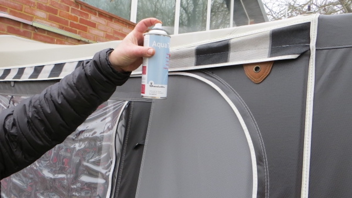

Once the canvas is clean, it is a good idea to treat it with a water reproofer, as the repellency capabilities of awnings can wane with time. Always check the instructions: some reproofers (such as Nikwax Tent & Gear SolarProof, which also boasts UV-blocking characteristics) can be applied to damp fabric, while others (such as AquaTex reproofer spray) need to be applied when the canvas is dry.

It's also a good idea to give the groundsheet a thorough clean. I use an all-purpose caravan cleaner diluted in a bucket of water and apply using a stiff brush. This is followed by a good soaking with the hose.

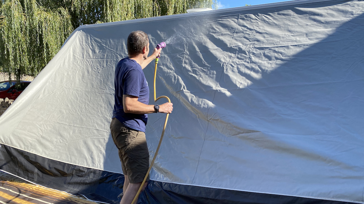

Stage 4: Spray with water and give it a thorough brush down using a wet brush.
Stage 5: Spray with cleaning product, then use a wet brush to rub it in and create a foam. Repeat if necessary.
Stage 6: Rinse off until all the residue has gone.
