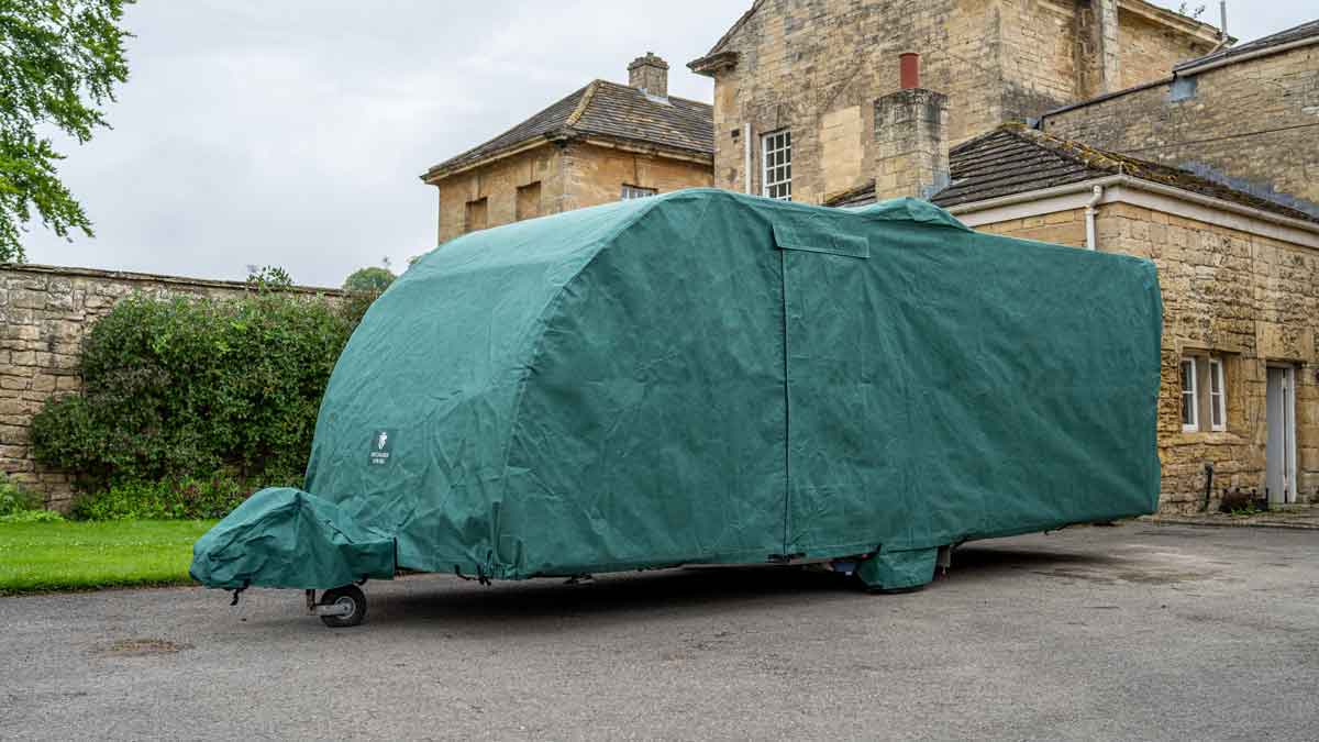

Purchasing a good, breathable cover will help protect the vehicle from the elements and also reduce extra spring cleaning.
