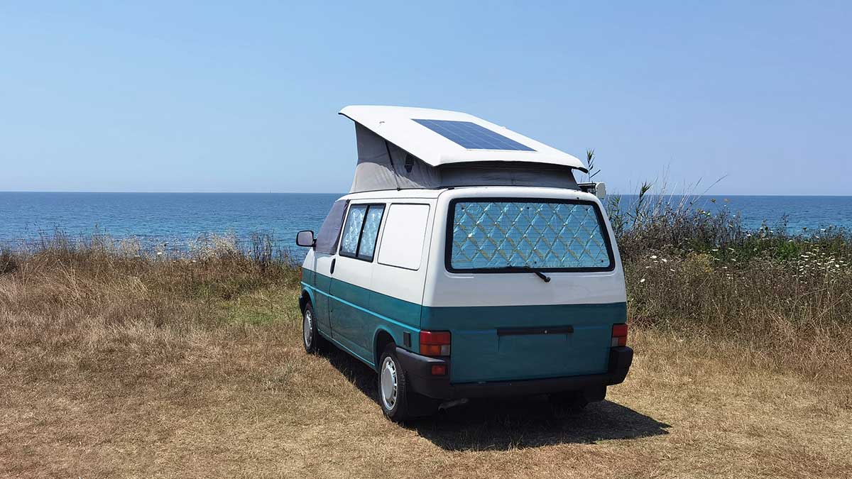

I just want to keep my leisure battery topped up while in storage.
Roof-mounted panels will typically be able to do this, but keep in mind that as we head into the winter months, the sun is quite low in the sky and the days are shorter. This means that a horizontal panel will consequently not produce nearly as much power as it would in the summer.

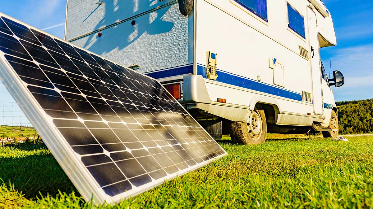

The solar panels' functionality can be restricted by dirt, leaves, snow, and, of course, a weather protective cover, preventing them from working properly. Some people choose to use a portable panel instead, usually one of the folding, 'briefcase' style ones because it can be adjusted to an angle towards the sun. Position your motorhome or campervan the right way and you may be able to place a panel inside one of the larger windows, although due to the window tint they will be less light coming through.
Some people like to try one of the very small, very cheap solar panels, which is normally about the size of a small book. Be warned, their output is very low and they will rarely produce enough power. Experiment with the location of your panel and make sure it’s angled towards the midday sun, this will maximise the chances of it working. Always try to fully charge the battery before storage, to give the solar panel the best chance of keeping it topped up.

There’s a big difference between 2-3 days off grid and 3-4 days off grid. A decent size solar panel of 100W or more, will certainly support a good battery. It probably won’t necessarily recharge it fully, but it will lengthen the time before it’s discharged.
It’s perfect for that long weekend spent at a weekend rally, a trip to a festival or even on a basic Certificated Location campsite. However the performance of the solar panel will always be affected by the time of year and the climate.
