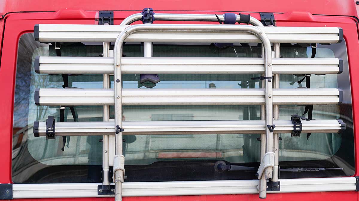

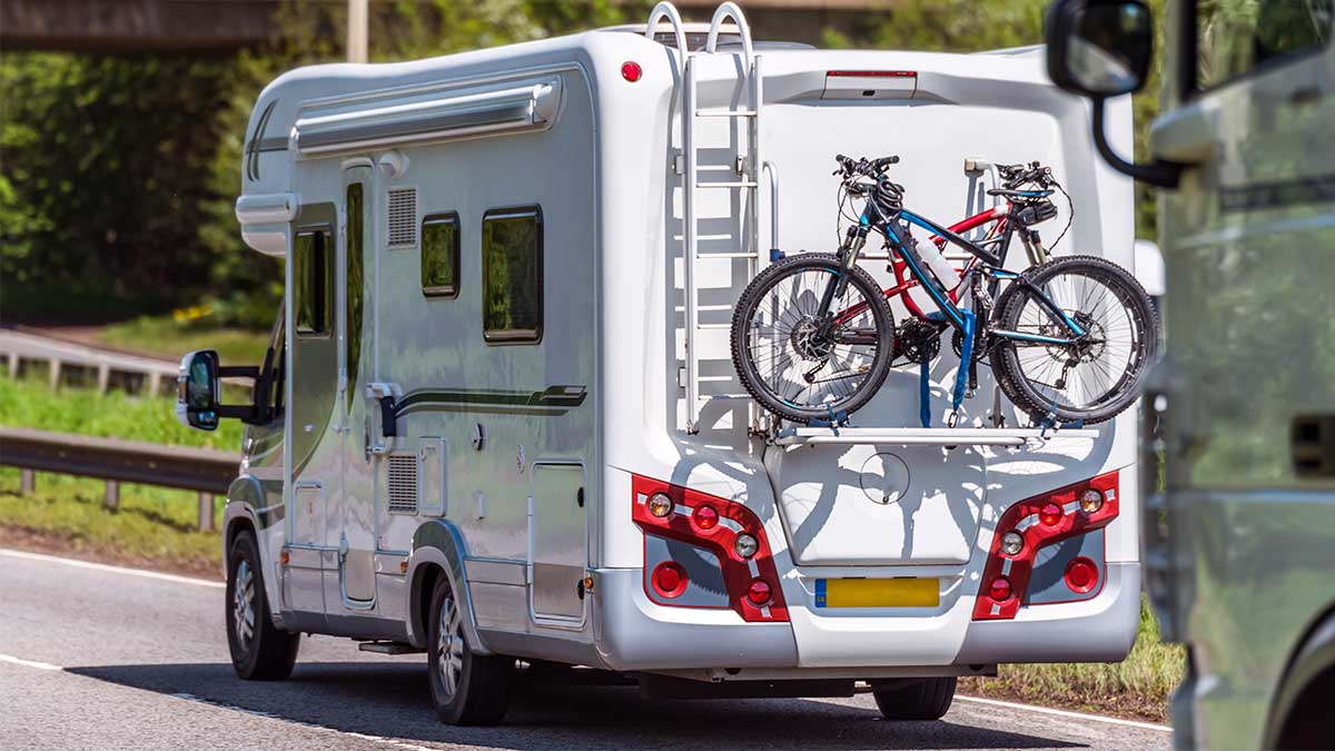

Cycle rack on the back of your outfit
The most popular and practical place to store bikes is a rack on the rear wall of your motorhome. Many motorhomes already come with some element of pre-fitting for a rack, but when fixing one to a coach-built body, ensure the securing bolts have been driven into a solid framework. If you are buying a new motorhome, it's worth looking into getting a rack fitted by the manufacturer. Hanging bikes, especially e-bikes, on the back of a motorhome may affect stability, so always check your loading and set-up carefully, before setting off.
The law requires your vehicle’s number plate and rear lights to be clearly visible, and therefore a cycle carrier lighting board will more than likely be required, unless you mount the rack quite high up like the one in the photo above. That could be very challenging to lift the bikes on and off of. This lighting board plugs into your 12N road light socket or your 13-pin combined socket, usually fitted for use with a towbar.
