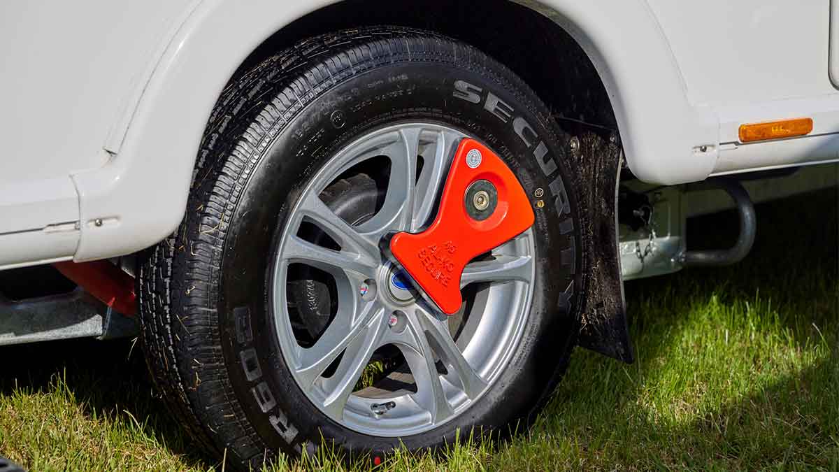

Wheel locks:
As the name suggests, these lock the wheel to the axle, preventing it from rotating. They’re probably the most effective way of immobilising a caravan, and require serious tools to get them off, as well as increasing the risk of peripheral damage. It is quite straightforward to use wheel locks on a single axle caravan, but can be a bit challenging to fit to both axles on a twin, which your cover provider may require.
This requirement is to avoid the method where thieves can tow a twin axle caravan at least a short distance with one axle still locked, by using extreme towball heights. If you do only lock one axle, always lock the rear one, as it is much harder to take weight off by this technique.
