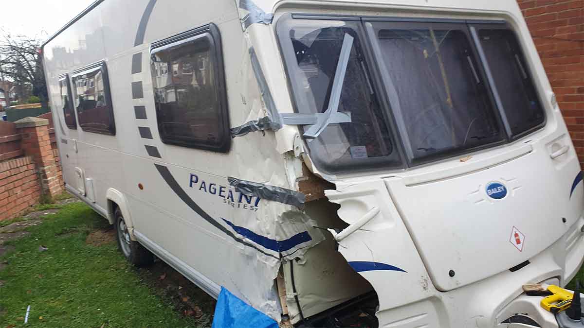

The vast majority of claims are caused by not hitching up correctly. Detachment will often happen immediately as you pull away, with a relatively low risk of serious damage or safety. However, if your noseweight (downward load on the towball) is reasonably high, the hitch can sit on top of the towball until you reach significant speed.
Whereas a low speed detachment could just damage your towing electrics connection, which would mean a repair before you are able to tow again, a detachment at speed might not just cause serious damage to your caravan and other vehicles, it could also cause a collision resulting in serious injuries or even worse.
How much can a detachment claim cost?
Although the average claim is around £5,000, a detachment claim could cost hundreds of thousands of pounds.
Why are detachment claims so costly?
Sometimes the damages to your outfit can result in your caravan being written off. Larger claims occur if a third party is involved, this can mean other people and/or their property. These types of accidents can be extremely serious, as a person could be injured or even killed. Tragically, such incidents have happened, with enormous emotional cost, irrespective of the financial implications. It’s worth noting that drivers may be prosecuted in such cases as well.

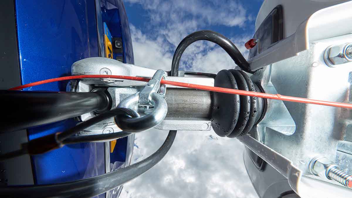

Our Technical team has provided a handy 7-point ‘Yes’ checklist to help minimise the risk of detachments.
  1. Is the hitch fully down over the tow ball?
  2. Is the hitch head lever fully closed (down)?
  3. Are the visual indicators (if fitted) showing the right colour?
  4. Has a secure coupling been achieved? Ensure the jockey wheel has been wound down until it raises the back of the car by 25-50mm and the rear of the car is just being lifted, rather than the rear suspension just uncompressing
  5. Is the breakaway cable in good condition, with no kinks, frays or damage to the cable or any coating?
  6. Is the breakaway cable correctly routed, passing through the cable guide under the hitch, loose but not dragging, and will not snag or pull taught on full lock?
  7. Is the breakaway cable correctly attached? If it has a thin spring clip, it should be looped through an attachment point on the towbar and clipped back onto the cable.
    If it has a more substantial carabiner-type clip it can be clipped directly to an attachment point on the towbar instead.
    All the recent designs of the towbar have an appropriate breakaway cable attachment point, but if it doesn’t exist, the cable can be looped once around the towball with the clip clipped back onto the cable. The UK law states only the use of breakaway cables, and doesn’t define a specific attachment method.
