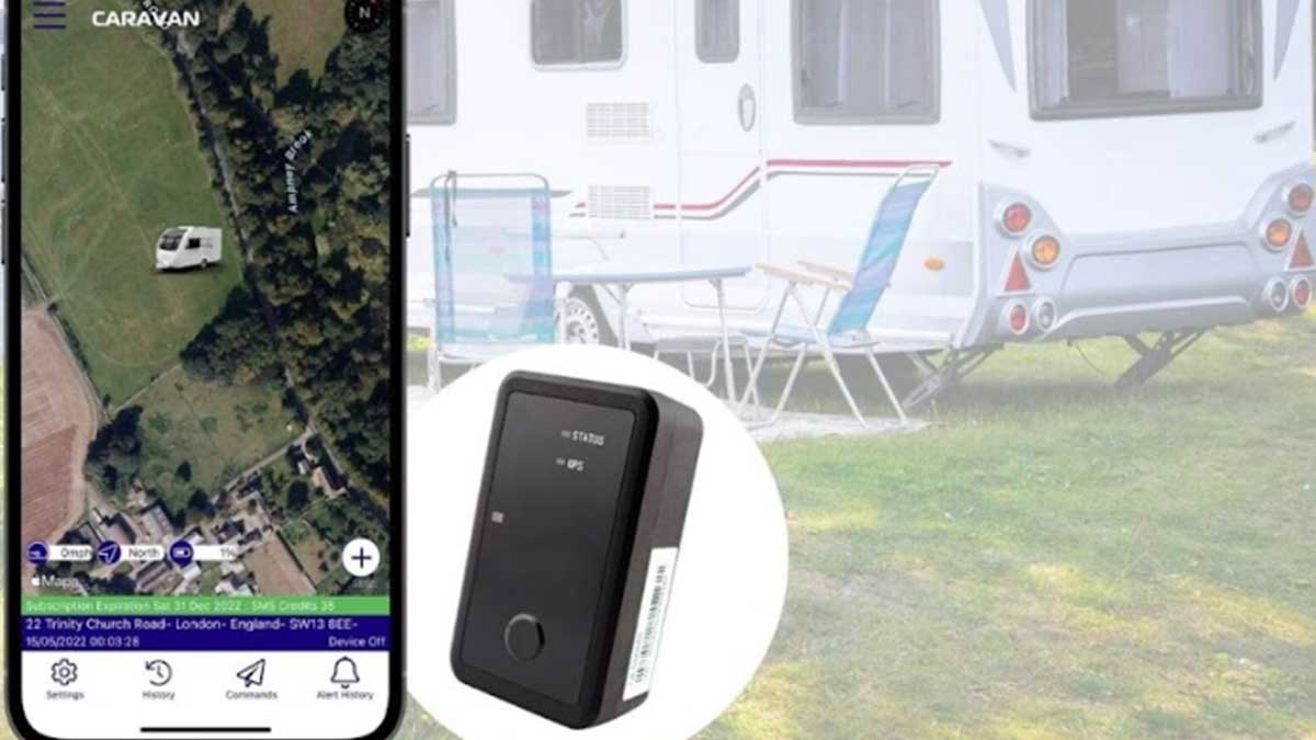

TS10 Caravan Tracker from Tracker Shop
For electronic automotive security products, for example: alarms, immobilisers and trackers, the recognised authority is Thatcham Research, the insurer-funded test and safety research organisation. For trackers, Thatcham S7 and S5 categories were introduced in 2019 and replace the former 7, 6 and 5 categories. The lower the number, the more sophisticated the system, although 7/S7 is still very good. S5 for instance adds use of a driver identification device for further protection.
You should check the manufacturer details to make sure that the products are optimised for caravan use, for example: one that has a low power operation to preserve battery power whilst in storage. Currently, we are not aware of a caravan-specific alarm accreditation scheme.
