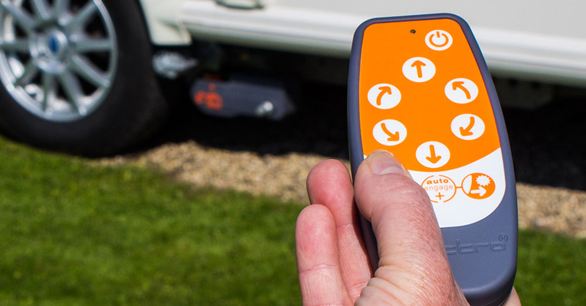

What’s your advice when choosing an electric caravan mover?
Feedback from Club members is overwhelmingly positive in terms of the performance of all models. However, these devices do sit in an exposed position, and are vulnerable to minor damage and wear and tear. So it’s sensible to check for good warranty cover and spares availability from the supplier when purchasing.
Also (and especially where twin-axle movers are concerned), check if the mover will obstruct access to normal jacking points – you might need to use a low-profile scissor jack under the axle if that is the case.
If you store your van without clear access to one side, make sure you choose a model with remote (dis)engagement of the drives. Finally, take care choosing a fitter. It’s important that the mechanical components are adjusted properly, and really important that the electrical wiring is done correctly and safely.
